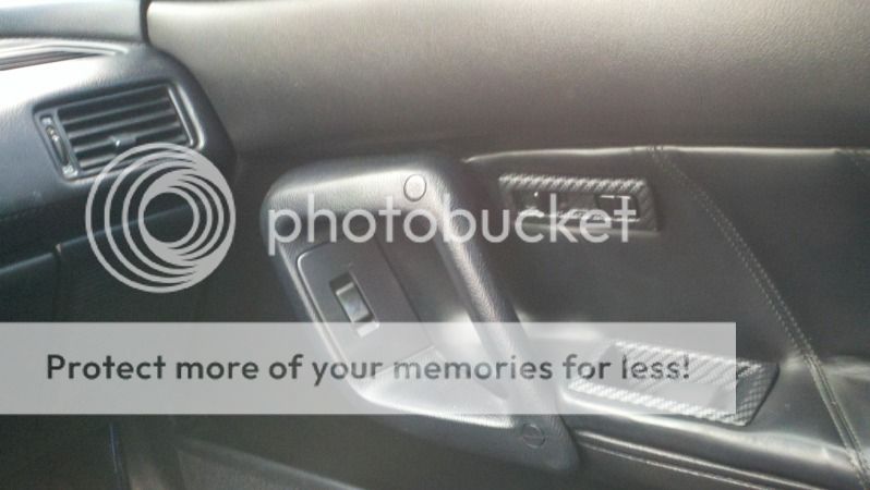

Postby ZeroDrift » Fri Aug 31, 2012 3:27 pm
Some wrapped parts:
Any use the 3M wrap material on interior parts?
Postby celigts » Thu Sep 20, 2012 3:09 pm
Have any of them let go yet? I heard curves are terrible for letting go.
