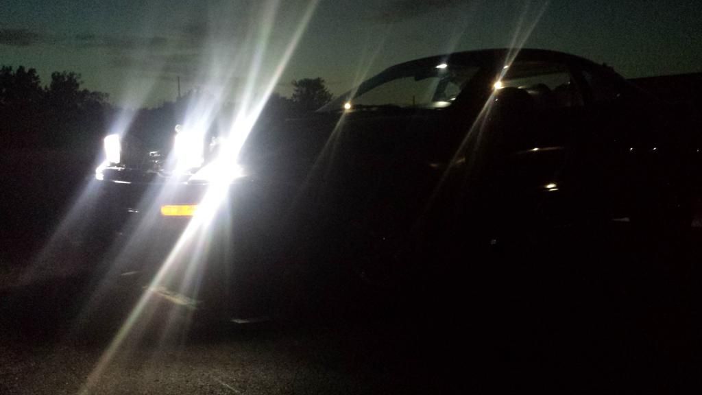

PostPosted: Fri Aug 22, 2014 1:54 pm
by monkracing29
My favorite photo from last night.
What do you guys think?
