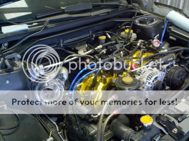

May as well show mine.
During prep, but post paint:
Also redid the trunk and plastic parts with the same bed liner. Helped immensely with durability when hauling anything.

Postby Hotrodhendrix » Mon May 07, 2012 5:31 pm
Which liner did you use in yours?
Re: Best spray can undercoat, suggestions
Postby ZeroDrift » Mon May 07, 2012 7:44 pm
Hotrodhendrix wrote:Which liner did you use in yours?
I believe it was Rustoleum's offerings. I decided to opt for the roll/paint on kind.

Postby ZeroDrift » Mon May 07, 2012 8:01 pm
Hotrodhendrix wrote:Nice. The Hurculiner I used has a very bumpy texture. I dabbed it on with a paint brush as the roller didnt work well. Have you had an peeling or anything? I only found one small spot where I didnt get it cleaned well enough and it peeled off easily.
I only had one small piece flake off in the trunk. Tossed in a differential or something and it caused a several inch flake to come up. What I did for the engine bay was degrease everything with Simple Green with a pressure washer, then going over it with some sandpaper or something to promote adhesion. Did this several times to ensure no grease was remaining. I didn't do the same level of prep work for the entire trunk apparently...
The Rustoleum product didn't have have large particles in it like the Hurculiner (which I have used inside my ST165 speaker pods). I tried the roller method, but quickly found that a 3" paint brush was more productive with the many contours of the engine bay.
