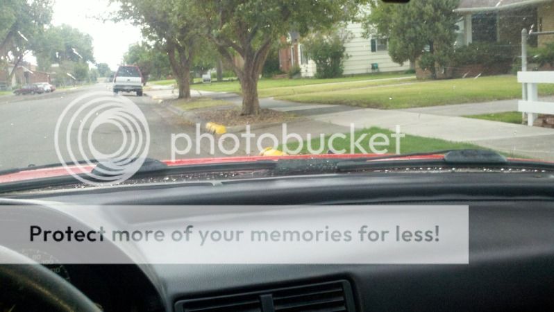

Postby ZeroDrift » Sat Jul 07, 2012 12:28 am

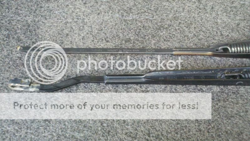

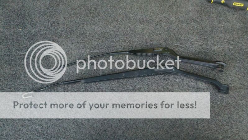

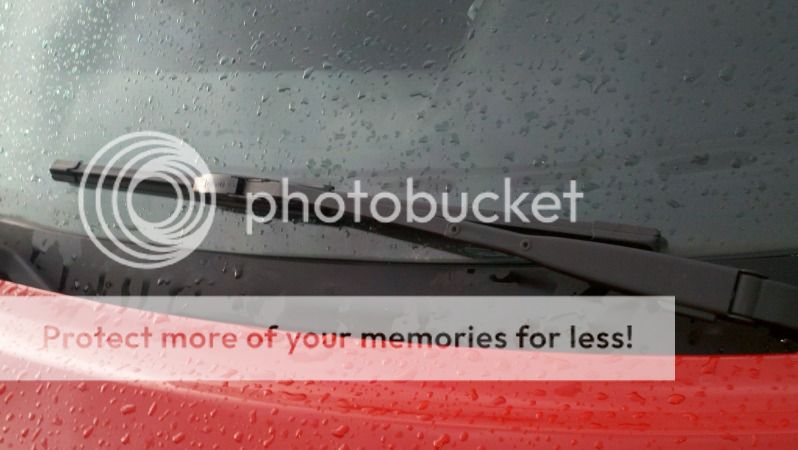

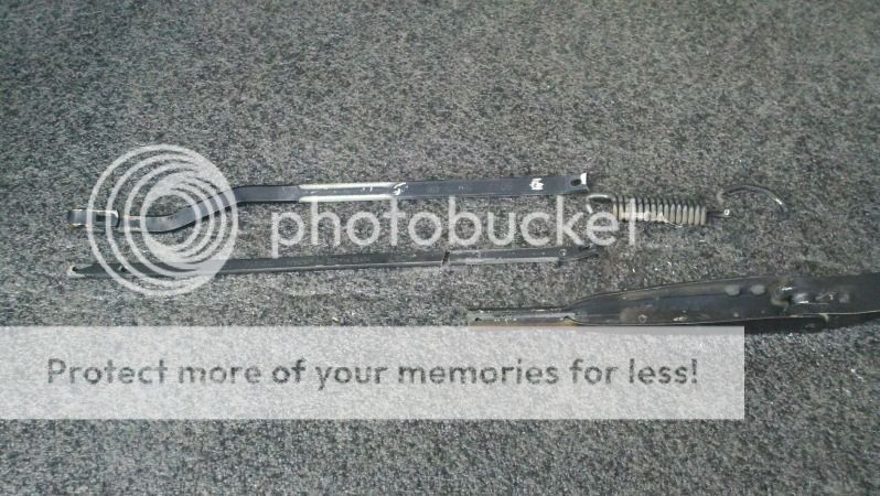

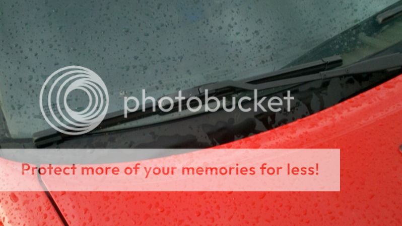

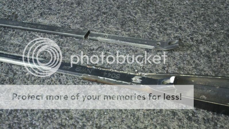

Well it was sunny with afternoon showers forecasted. So I decided to try the window wiper modifications today!
All in all, it took only 2 hours from start to finish and they work amazingly well. I will post pictures tonight.
Re: ST165 Window Arm Update
Postby ZeroDrift » Sat Jul 07, 2012 12:56 am
Quick DIY guide:
Parts:
-Passenger side Paseo wiper arm (for passenger side)
-Drivers and passenger side Saab 9000 wiper arms (drivers side for drivers side and passenger side for the rear)
-Rivets (stainless is ideal)
Tools:
-Grinder/saw
-Standard screw drivers (pair)
-Rivet tool
-Pliers
-Paint
-Extra set of hands to help
-Welder for the rear arm... (not yet finished...)
Pictures should speak for themselves! If you need more help I can put in more detailed directions.
