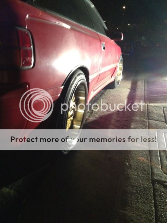

Postby monkey8oi » Fri Mar 08, 2013 1:07 am
just got my new rims.. 17x9 +22offset, tires are 215/45/17
monkey8oi
Posts: 780
Joined: Tue Aug 31, 2004 5:11 pm
Location: South San Francisco
Re: ST165 Wheel Spec Thread. Please contribute!
Postby GT4_DRED » Fri Mar 08, 2013 1:24 am
monkey8oi wrote:just got my new rims.. 17x9 +22offset, tires are 215/45/17
nice setup ..

Postby 88st165 » Fri Mar 08, 2013 1:48 am
Nice job! Im glad someone went out and tried aggressive wheels on a 165. Can you run a little bit more camber or will the wheels rub the suspension? BTW what suspension are you on, stock or coilovers? I believe the clearances are different on each.

Postby monkey8oi » Fri Mar 08, 2013 6:09 am
Thanks!! Running tein coilovers.. Fronts rub a bit but gonna adjust the camber to correct it. It shouldn't effect the clearance with the suspension..
