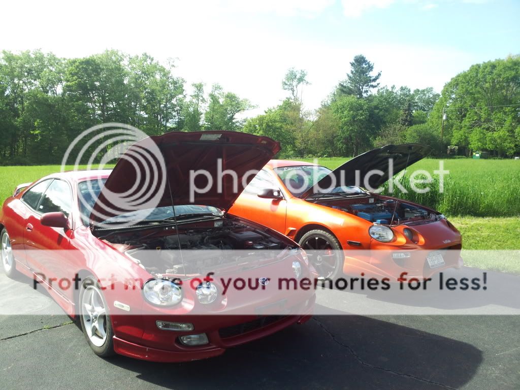

Here are some pics from my celicas (its like cutting off most of the images on my screen… idk why? maybe someone does)

I have two ST's now, but I have swapped a 3sgte into one (making 320WHP and 300FTLBS back when I had the CT20B, I have a TD06 setup now). I plan on buying a GT shell though, not because its really any more difficult to do than an ST, but they have some parts I will need and generally have more options (power everything, sunroof, ect.)
