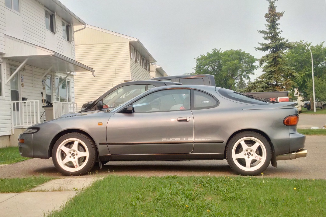

Postby CMS-GT4 » Fri Jun 19, 2015 2:26 pm
The 17s better suit the car. Look good.
Posts: 10357
Re: 1026 GT-Four Normal Body
Postby CSAlltrac » Fri Jun 19, 2015 8:03 pm
Mirrors and wheels look great! That wheel gap though :wink:

Yeah the car could stand to be half an inch lower now. Coilovers are still on the wish list.

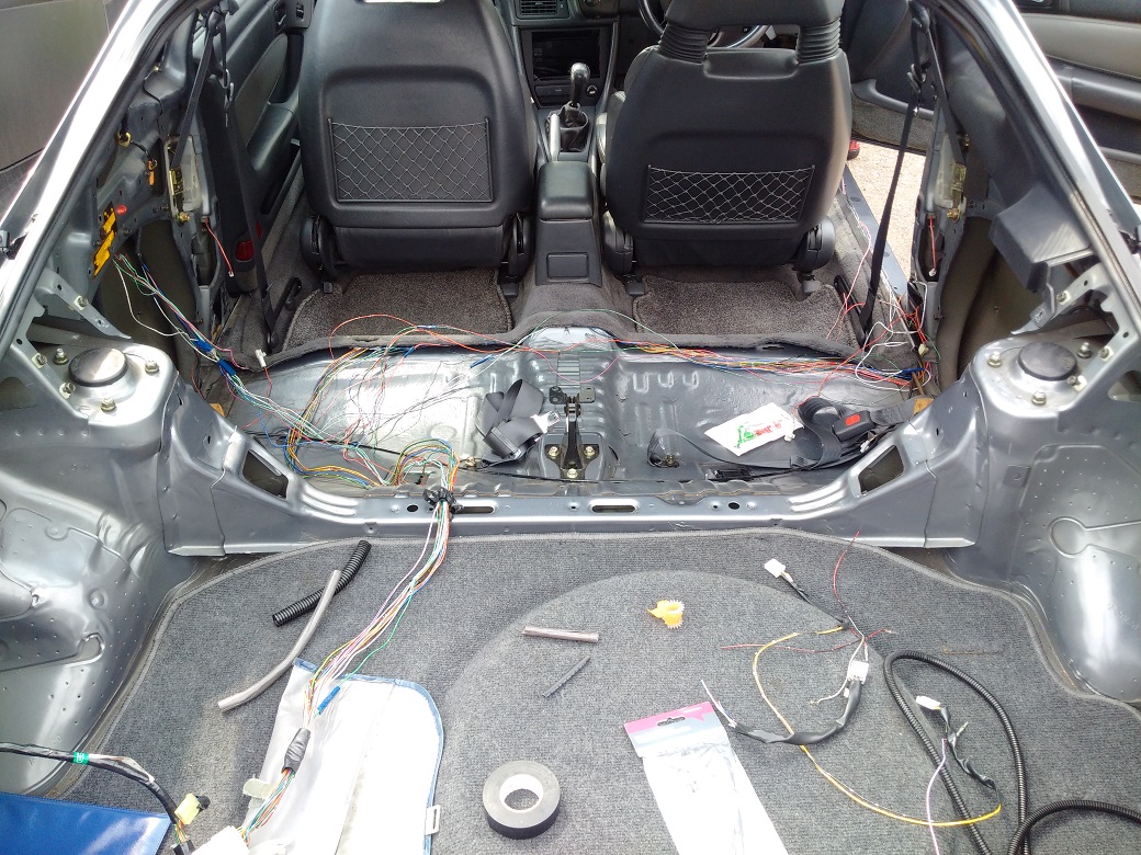

I removed the rear interior plastics the other day to get at a rear quarter panel dent I caused a couple weeks ago when I dropped a tool. Took it to a guy in Edmonton to get fixed and he did a good job getting it flattened back out.
But while I was at it, I decided to remove all the excess wiring harnesses in the back half of the car. ABS, speaker and antenna harnesses have now been deleted.

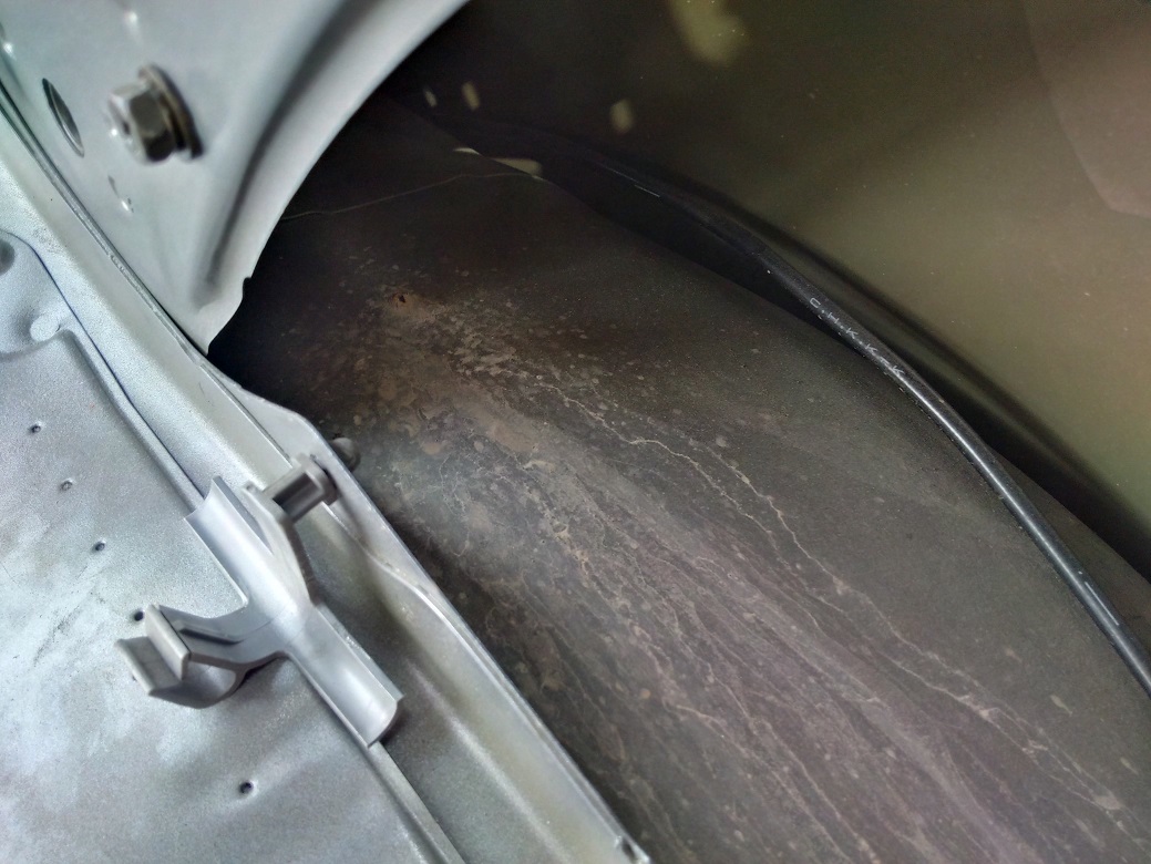

That project is now done and I'll post some pictures up soon once I organize them. BUT, then I found some concerning areas of small rust formation on the panels aft of the front doors. This is caused by a leaky foam seal on the black plastic door vents (in the door jams) and a bit of water finding its way into the sunroof drains.
Last time I checked these areas 3 years ago, they were perfect.
I also found damage to the rear left wheel well. - Something managed to puncture the rubber rock-guard-coated steel near the top of the well. This has allowed water to trickle down the top face of the well, towards the front of the car. It should be an easy fix.
So, needless to say, I'm glad I decided to dive into that wireing removal project, or else I never would have found these issues.

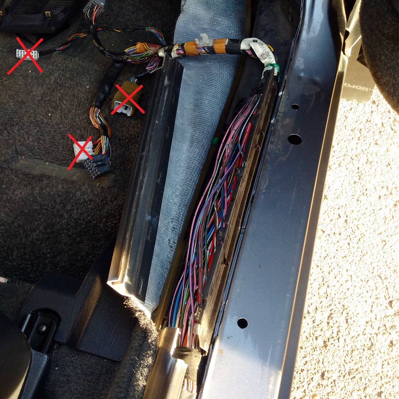

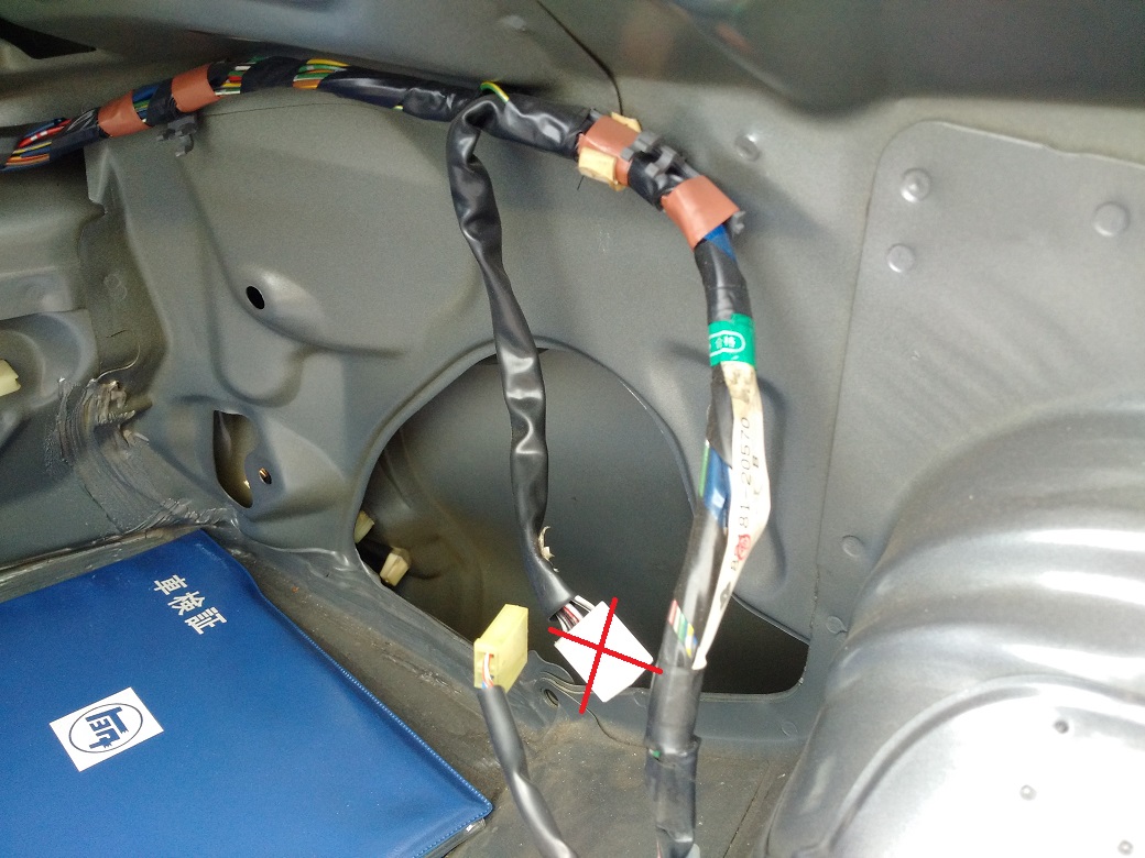

Harnesses for rear speakers, ABS computer and RR ABS sensor, and keyless entry computer.
All gone!
I also applied black RTV to those plastic nipples for the exterior plastic ding-guards. I found that some water was leaking into the car via those holes. (RTV wasn't yet applied in this picture)

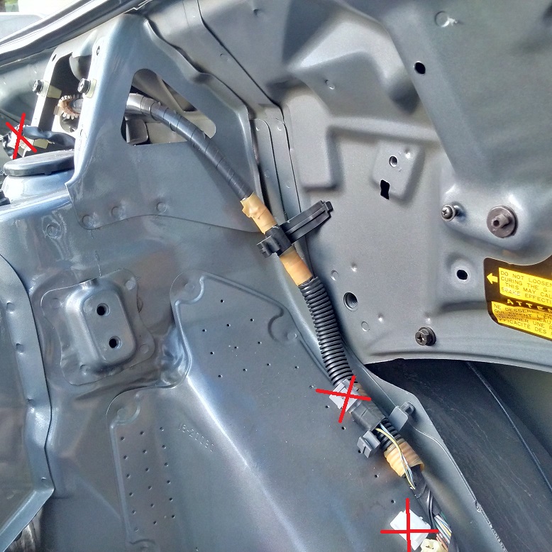

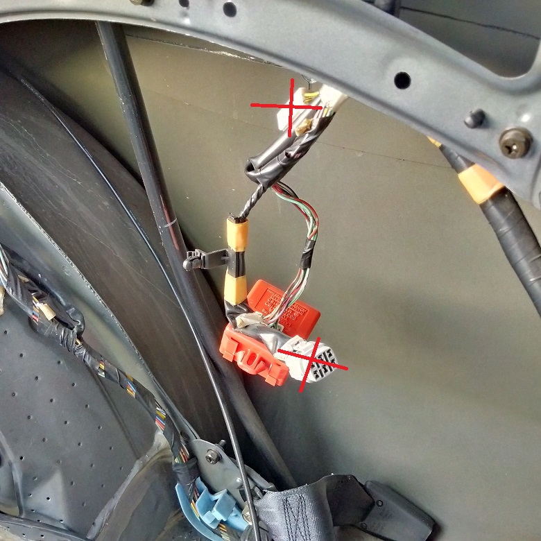

Harnesses for ABS accelerometer, rear speakers, power antenna, LR ABS sensor, and an extra connector that was never used - not sure what is was for.
Much cleaner - sorry for blurry picture.
Power antenna wiring deleted.
The number of connectors running from the back of the car to this kick panel has been reduced to just two, with a number of extra wires de-pinned from the remaining connectors.

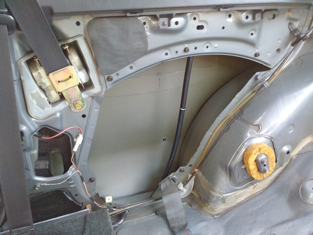

This surface rust was caused by the sponge and a leaky door vent seal. I washed both sponges, removed that rust and applied some paint to the area. I also made some new seals for those vents.
Here is that puncture in the steel wheel well. I filed the area flat, applied JB weld, and some rust inhibitive paint to repair it.

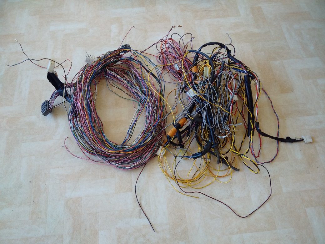

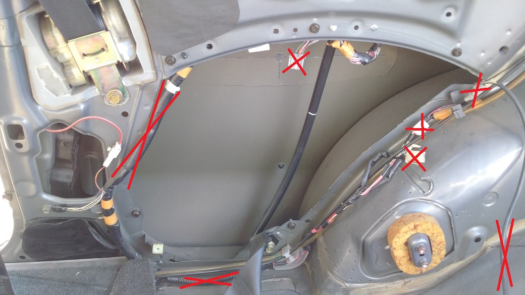

I didn't have access to a scale, but it's a lot of wire. I saved all the connectors since they are hard to come by. If anyone needs them, let me know and I can mail them out.
I took pictures of the work as I went so I could refer back to how the harnesses were wrapped. This way I could replicate it when re-wrapping. I used high quality 3M electrical tape and the OEM split coils and sheaths - can't even tell all this wire was deleted. I kept and reapplied the factory inspection labels and harness-part-number tapes.
Down the road I'll have to remove the front ABS wiring harnesses. The front harness connects to the rear harness I deleted via that large, foam wrapped white connector by the kick panel. I'll also delete the rest of the system 10 wiring if I ever have the entire dash out again.

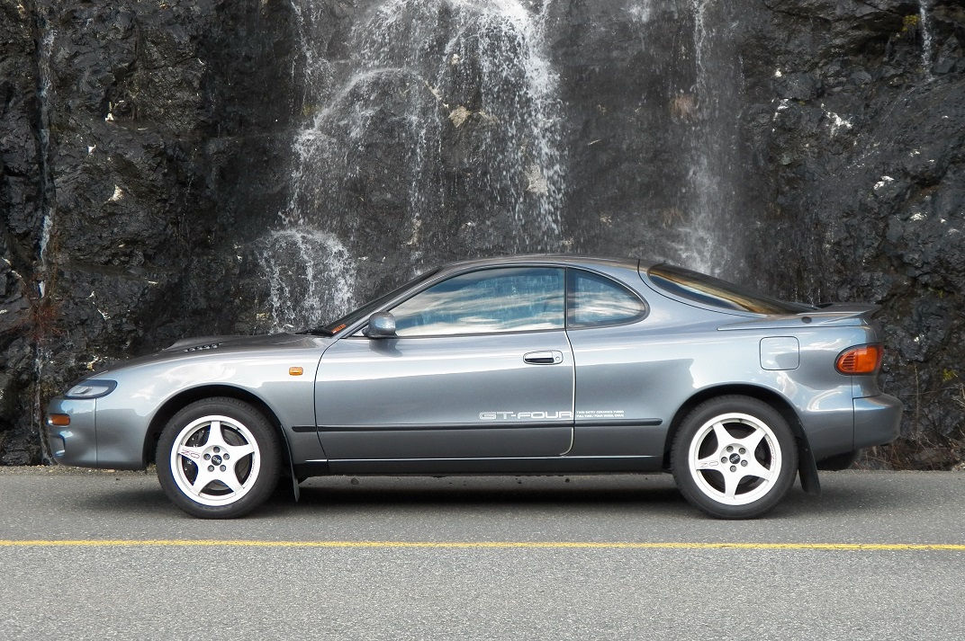

I resized the images in PS to scale them correctly. With the 17's the car is about 1.5 cm taller now, and it's noticeable in the corners. Next on the project list - coilovers or lowering springs.
