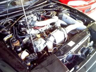

Just got done mounting my pair of Pro Series Bosch 044s in my tank. What a bitch that was... But the install turned out well I think. I plan on installing my new injectors tomorrow and should be retuning soon. If all goes well I might have to drive her around (and maybe to work) this coming week... :) .

Postby gt4gordon » Sun Apr 24, 2011 1:31 pm
How did you mount the fuel pumps and pipe them both up? Any pictures? You know we all love pictures.

Re: My GT42R st185 project (Dyno results on pg 24!)
Postby tjdouble07 » Sun Apr 24, 2011 6:12 pm
gt4gordon wrote:How did you mount the fuel pumps and pipe them both up? Any pictures? You know we all love pictures.
I have a video from inside the tank of me testing both of them, but for some reason every time I upload it the video goes upside-down... :shrug: I am putting my tank back on the car in just a little bit, but just for you I will pull the filler neck off again and take a pic inside. Trust me though, it was no simple task. A pain in the ass is more like it. I'll upload a pic or two in a bit.

Postby tjdouble07 » Sun Apr 24, 2011 6:54 pm
gt4gordon wrote:excellent thanks always wondered how people did it you still run the stock fuel lines?
Here you go. two -8 AN's out of the pumps into a Y-fitting to a -10 AN for my supply. 5/16" stock supply as my return going to a -6 JIC (industrial AN equivalent) custom return on the tank.

Postby tjdouble07 » Sun Apr 24, 2011 7:05 pm
sleeper wrote:
We can just turn our monitor :D :D
Why did you go for this setup and not just run a large external pump?
OK then, here is the test video in all it's upside-down glory.
I decided to go this route because I've had a big external pump and they are LOUD! My twin 044 setup is much quieter, comparable to my old twin walbros. So far I think I'm gonna like it... :smokes:
