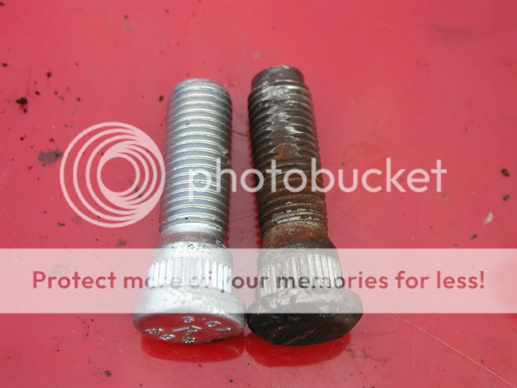

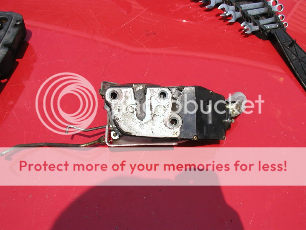

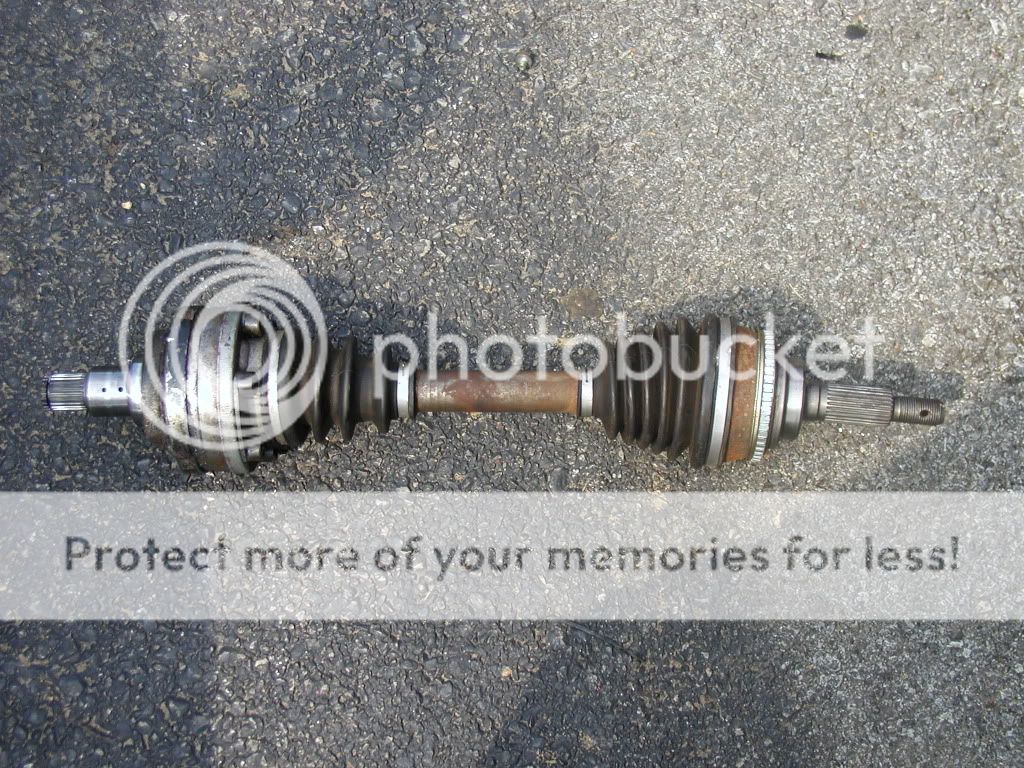

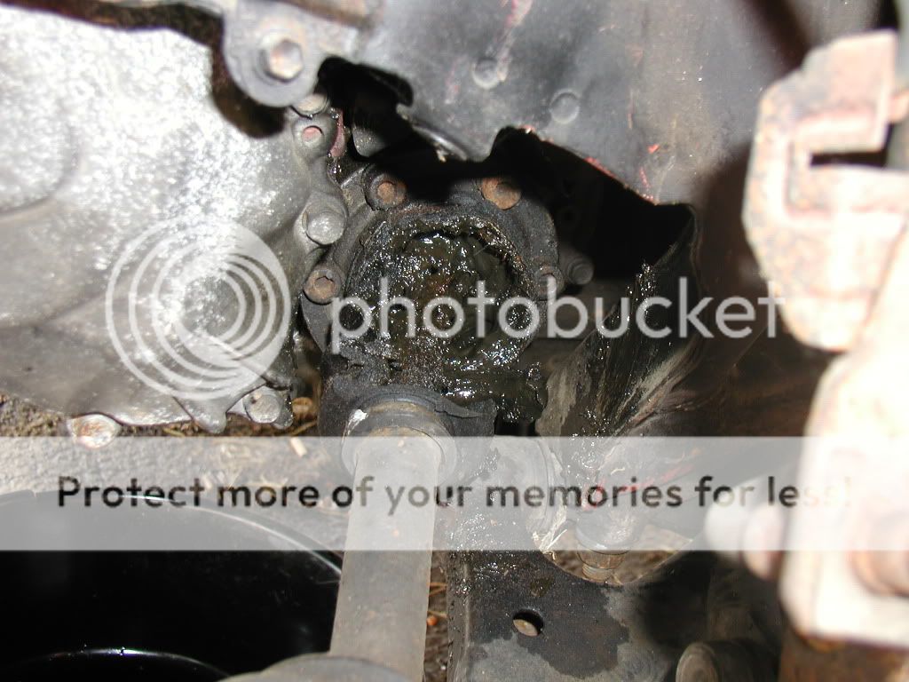

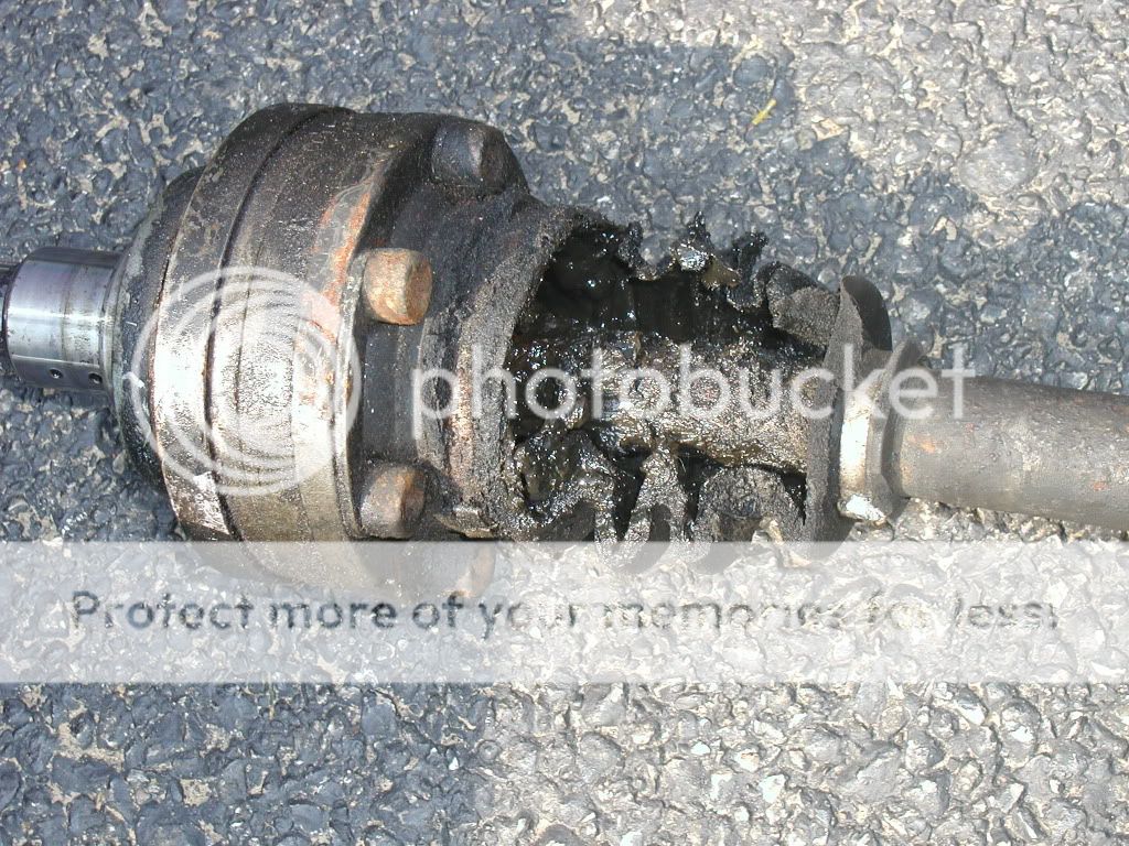

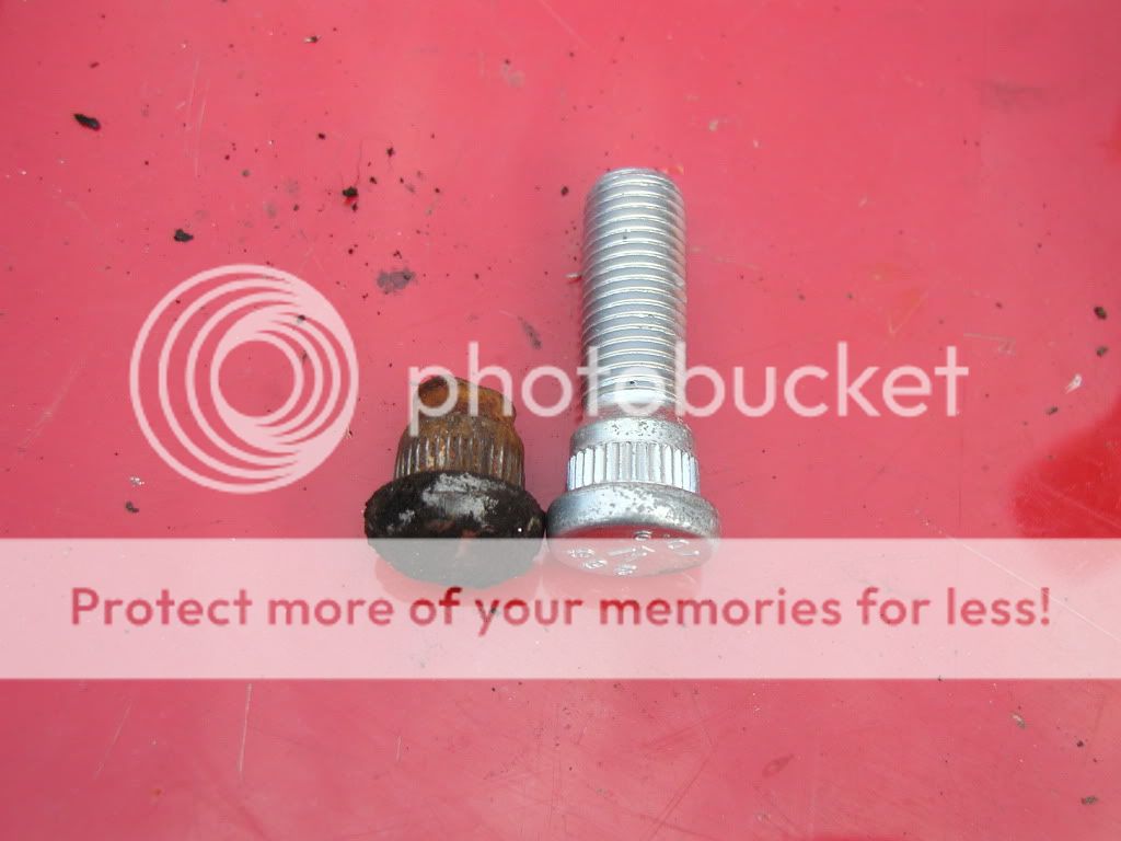

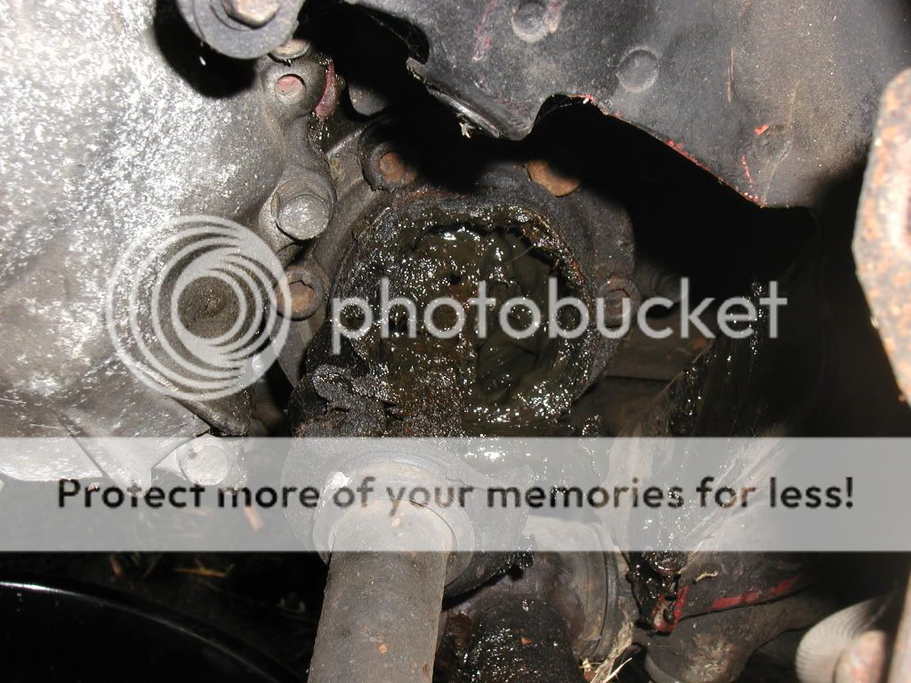

I have however done a little more mechanical work to it that needed to be addressed. First I replaced a couple wheel studs, one was completely broken as you can see in the pictures below and the other had flattened threads that stripped out any lug that you put on it :doh: :doh: . Second I decided to replace the drivers axle, you can see in the pictures that the inner boot was torn, and I had a spare axle so replacing it was cheaper than buying a boot kit. Lastly I replaced the drivers side door lock mechanism because when I would lock the door the motor would just grind like it had a stripped gear. Also if I tried to lock the passenger side lock the drivers side would remain unlocked, so it had to be replaced. This by far was the hardest of the three, not only because of the finicky plastic clips that hold all the levers in place, but because it was like 100 degrees and I think my brain was cooking because I was making all sorts of mistakes :oops: :doh: :oops: . First mistake was I put the new door lock in, and installed all the clips then noticed that I didn't remove the three bolts from the lock before I installed all the clips. So with everything connected I couldn't take the bolts off so I had to remove the lock and start over :cry: :( . Second mistake was after removing the lock to get the three mounting bolts off I reinstalled the lock, then put the access panel back in place only to find out that I didn't replace the two bolts that hold the door latch in place :twisted: :oops:. Last mistake was that after I removed the access panel and installed the two bolts to hold the handle in place, I reinstalled the door panel only to find out that my inner latch handle was sticking up like 2 inches because the latch was from a car that had a busted drivers window and a small piece of glass was lodged inside the lock holding the lever from sitting properly :doh: :doh: . So off with the entire door panel, and the lock, and the door handle again, this time to jiggle out a 1/4" piece of glass from the inside of the lock :oops: :twisted:. By this time my brain is sizzling from the intense heat, and I'm pretty sure that played a major roll in me being so confused by what should have been a simple lock swap :crazy: :crazy: :crazy: . My doors now lock normally without that annoying gear grind, and I can lock the doors from either side without any issues :smokes: 8) :D. So here are a few pics of what I was working on this weekend. Thanks for following Project Phoenix guys, and fingers crossed I will be working on getting Phoenix tagged and on the road soon :wink: :wink:
