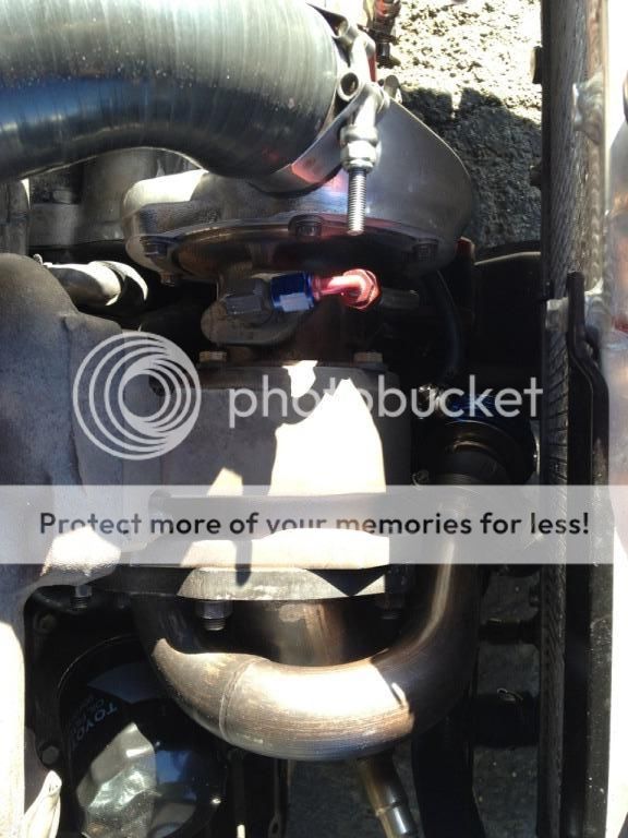

finally got the borg warner s252 turbo installed.. wasn't a straight bolt on and needed some fabricating done.. first off, the turbo hit the trans which did not allow the turbo to bolt on correctly.. to fix the problem, we grinded down a part of the trans housing.. here's a pic of what it looks like now..
other than that, the turbo install required buying a couple AN fittings but all in all, it worked out.. screemer pipe is really close to the radiator but does not touch.. the midpipe will require a little modification because it didn't quite reach the downpipe so i will have an extension welded on this weekend.
here's a pic of the turbo installed.
