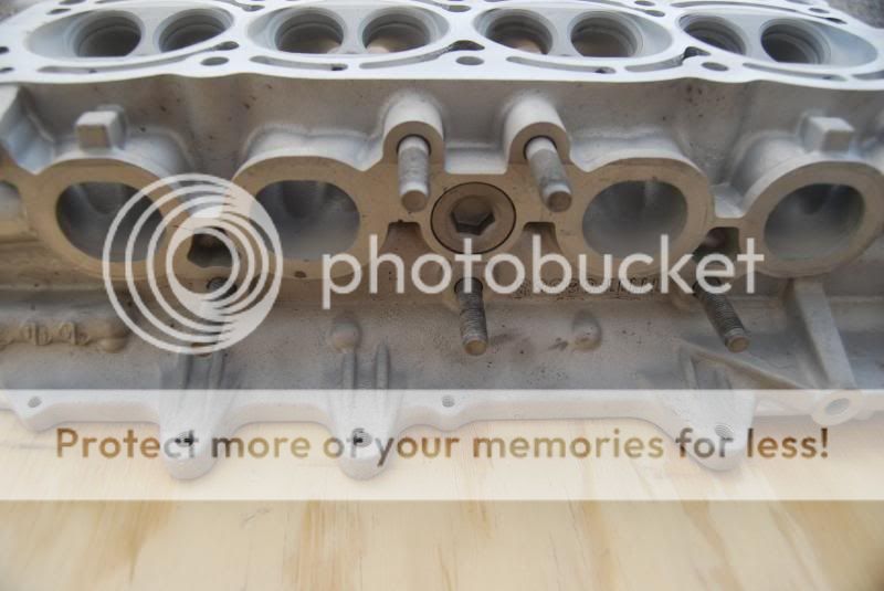

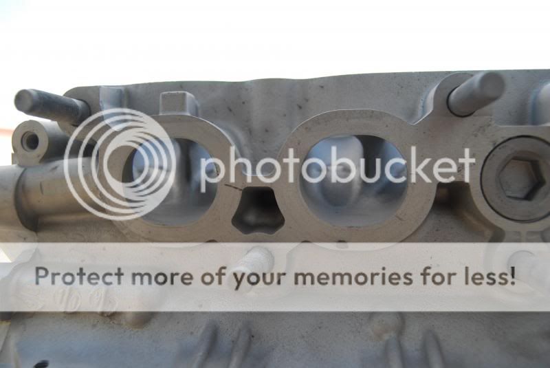

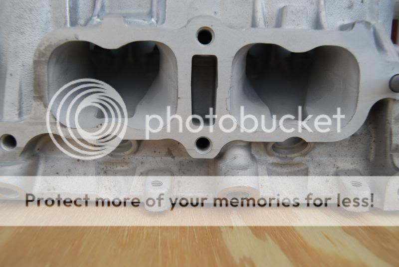

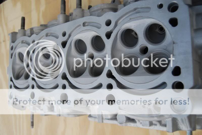

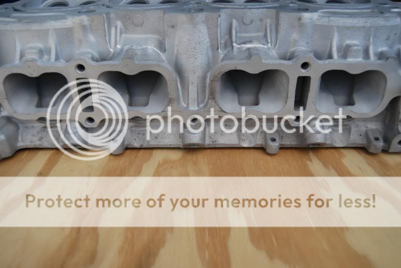

With work and the semester coming to an end, I've had no time to put into the car. However I was able to put in a a couple of hours into the head today. Surfaces are prepped and ready to be cleaned prior to being coated.

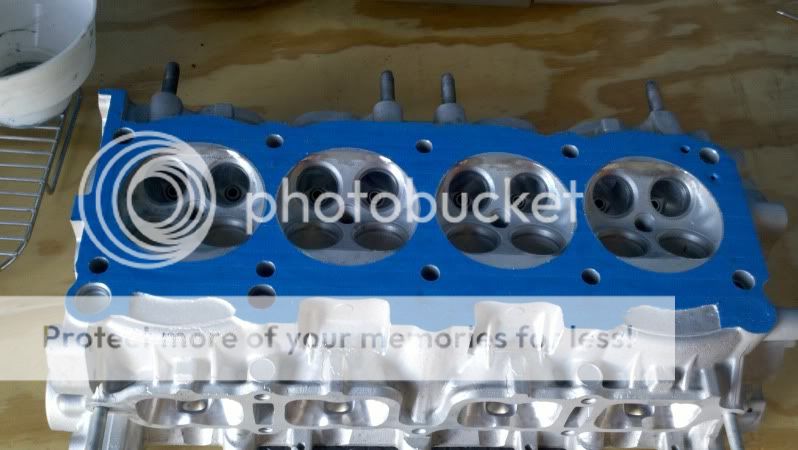

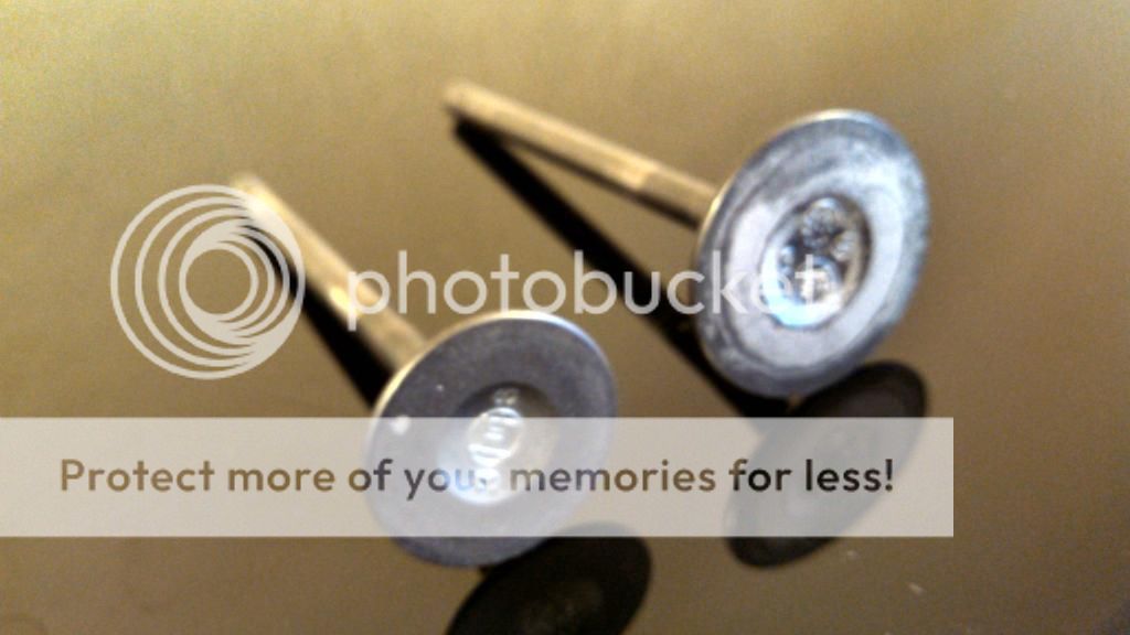

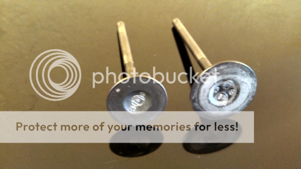

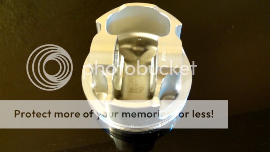

Been a while since I've posted anything here! Progress has been slow, but the car hasn't been forgotten! Recent work has mostly entailed a thorough cleaning of the engine bay and ceramic coating miscellaneous parts and accessories. Few new and old parts arrived for coating.
For those who have built these engines- is there any merit to aftermarket valves?
And because everyone loves pictures:
Re: ZeroDrift's 1988 All Trac. Engine Overhaul Project!
Postby ZeroDrift » Fri Jul 25, 2014 1:20 pm

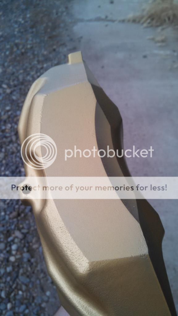

Few updated pictures. Coatings applied on the pistons and calipers. Valves are finished as well, but no pictures were taken of those. Still sorting out if they will be replaced at this time.

Postby zaluss » Fri Jul 25, 2014 4:41 pm
Maybe I missed it but more info on those calipers!

Postby ZeroDrift » Fri Jul 25, 2014 4:55 pm
zaluss wrote:Maybe I missed it but more info on those calipers!
They are forged aluminum monoblock calipers from a Lexus LS430. Cleaned and ceramic coated at the moment. Waiting on the brake kit from: viewtopic.php?f=8&t=48517

Postby ___Scott___ » Fri Jul 25, 2014 5:58 pm
It looks like the same coating on both the piston tops and on the calipers. Piston tops usually get a thermal barrier coating, and calipers usually get a heat dissipative coating.
If you have a thermal barrier coating on your calipers, you may want to rethink that decision.

Postby ZeroDrift » Sat Jul 26, 2014 1:01 am
Different coatings. The inside of the caliper has a different coating that is more of a thermal barrier. The outside is a standard coating and is used as a finish coating. Thermal dissipative coatings are something I more frequently apply, but is not always needed. Remember this is s street car, not a race car. A thermal dissipative coating would work better, but a typical coating is also fine.

Postby ___Scott___ » Sat Jul 26, 2014 3:44 am
ZeroDrift wrote:Different coatings.
Cool, it looks like you are on top of it.
