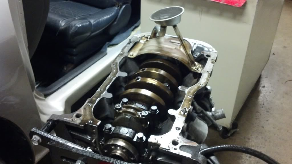

alright so we got down to the shortblock last night, went smoothly except for snapping 2 cam cap bolts off in the head :/. today we will be removing pistons and measuring things. stay tuned!
More to come...

Alright so no pictures last night, but i got the entire block and head stripped and into the hot tank for a few hours. tonight, we will be measuring the bores and rod journals as the rod bearings didn't look too great but we shall see when the mic's come out...

alright, so last night I honed the cylinders out and started reassembly. I got a little worried when i measured the cylinders they appeared to be about .005 under spec, but ALLDATA had the wrong, or more like too far rounded, spec, which was 3.39". not exactly correct. once i got the correct spec, it was all good, just a tiny bit out of round.
Anyway, block went into the hot tank again after honing, new pistons went in, and the bottem end is almost completely assembled. Head has not been touched yet, unfortunately. that will be tonight, i hope.
