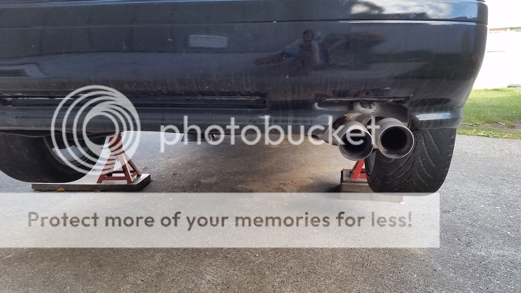

Postby SkagTits165 » Tue Sep 29, 2015 1:16 pm
I bought the downpipe 4 years ago, dont remember the brand

Postby zaluss » Tue Sep 29, 2015 1:40 pm
SkagTits165 wrote:[url=http://s1315.photobucket.com/user/noguchi77/media/obx_zpskcadlqsj.jpg.html]
I was looking at the same exhaust. Seems to be a lot of variations at different price points for the same thing.
Think you could snap some more pictures of what it looks like from the back and underneath? I'm also curious about how much 'love' was required to get it to work correctly.

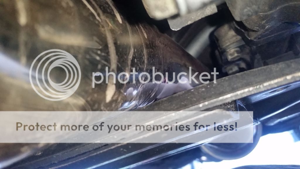

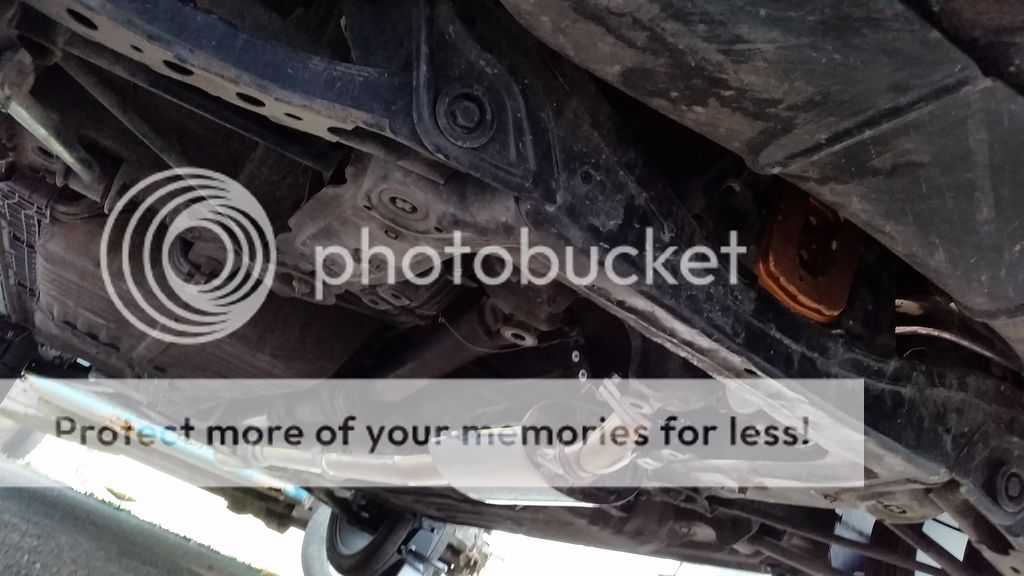

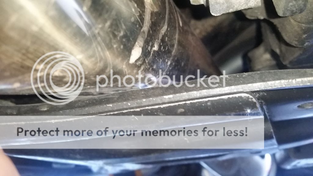

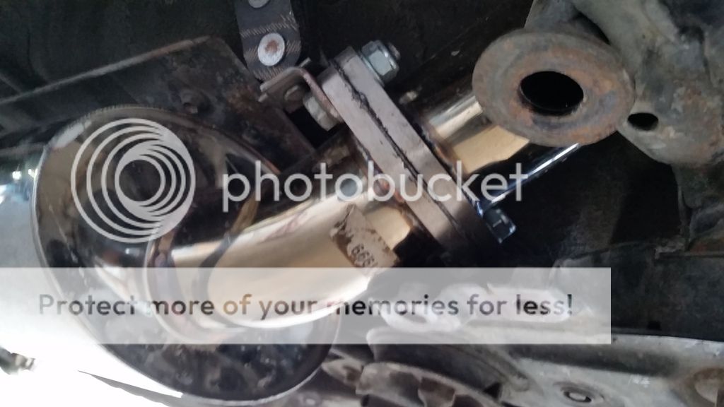

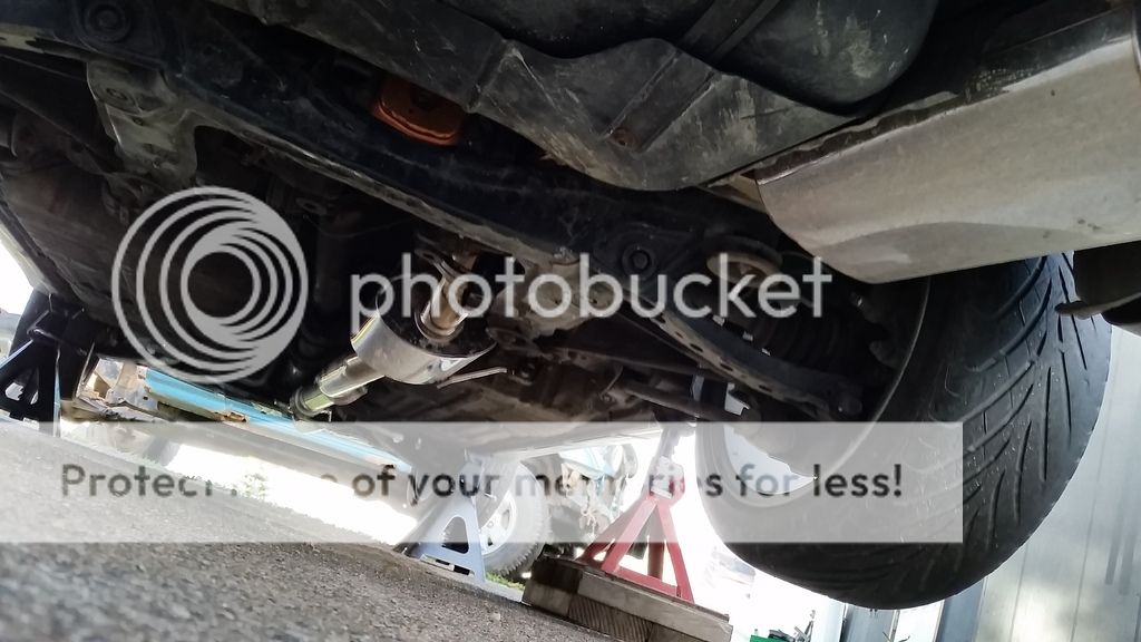

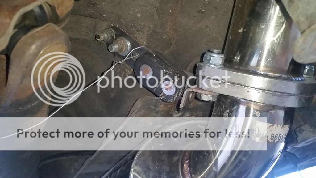

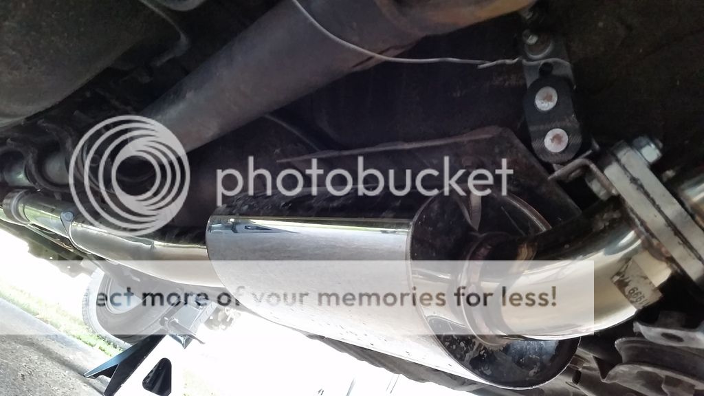

Postby SkagTits165 » Wed Sep 30, 2015 1:08 pm

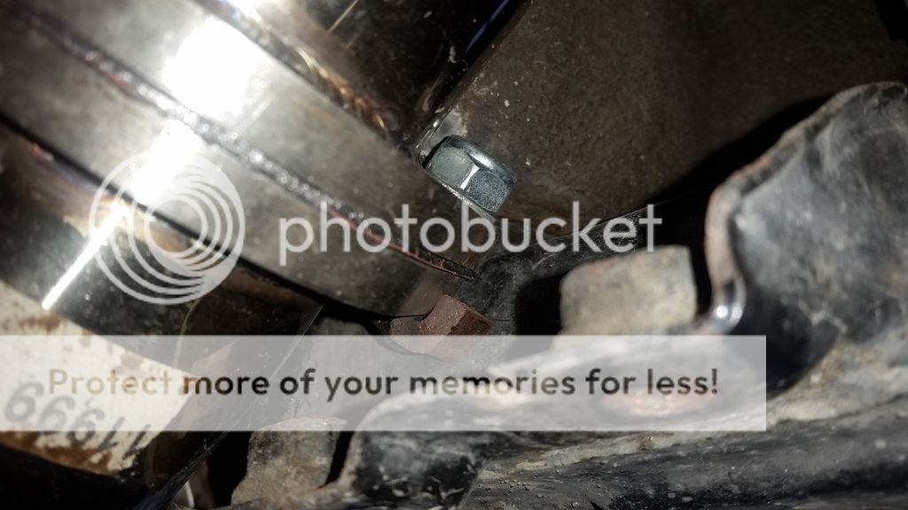

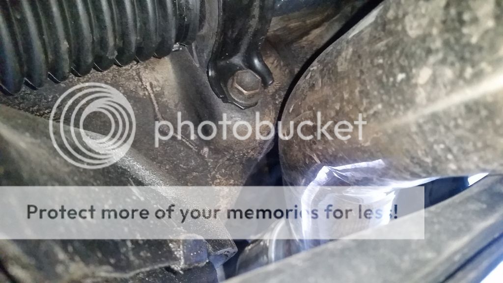

A full day it took to fit. You cant really tell in the pictures, but i had to deform certain sections of the exhaust. I built a jig to hold the exhaust to bench, while i beat with rubber mallet. The largest deformity was maybe 2mm deep. When i first assembled pieces under car, i never thought that it would fit without cutting and welding, but it did. I had 2mm wood spacers to insert between the exhaust and the suspension/body where the clearances were tight. then as i tightened from front to back i would see where i needed to deform. It was quite the job
I built a new hanger to help hold the exhaust where i wanted it ahead of the rear suspension. The ss wire is holding up my driveshaft until the rear diff is back in.
I had to build the nut in this picture that would hold itself, as i couldn't get a wrench to hold it

Postby zaluss » Thu Oct 01, 2015 2:02 pm
SkagTits165 wrote:A full day it took to fit. You cant really tell in the pictures, but i had to deform certain sections of the exhaust. I built a jig to hold the exhaust to bench, while i beat with rubber mallet. The largest deformity was maybe 2mm deep. When i first assembled pieces under car, i never thought that it would fit without cutting and welding, but it did. I had 2mm wood spacers to insert between the exhaust and the suspension/body where the clearances were tight. then as i tightened from front to back i would see where i needed to deform. It was quite the job
<Pics>
Oi. Maybe I'll be heading down to the exhaust shop afterall. I also inquired to Klue about a Bully clutch as it appears my ST205 swap needs one.

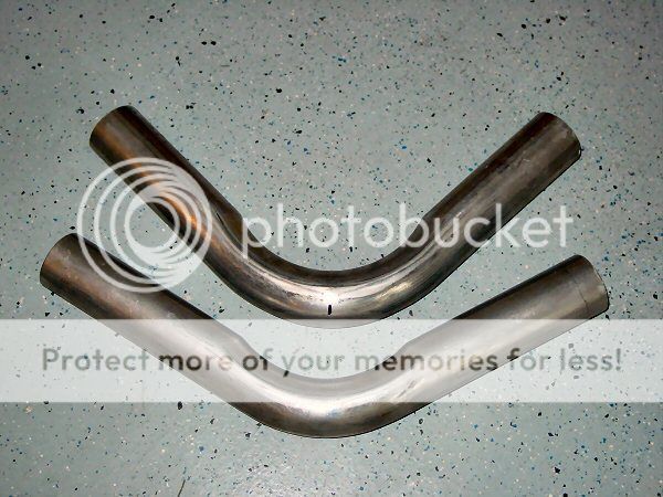

If you are going to a generic muffler shop, be prepared for some gross looking bends, not nice mandrel bends.
Probably look like this

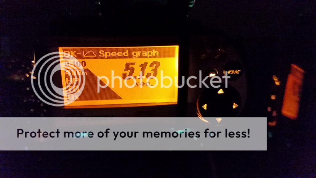

Dug out my old gtech pro and went out on wet streets with my winter rubber. Heavy spinning in first gear, and running 15lbs boost

Postby SkagTits165 » Sat Feb 27, 2016 8:17 pm
Still too much spinning, but decent times
