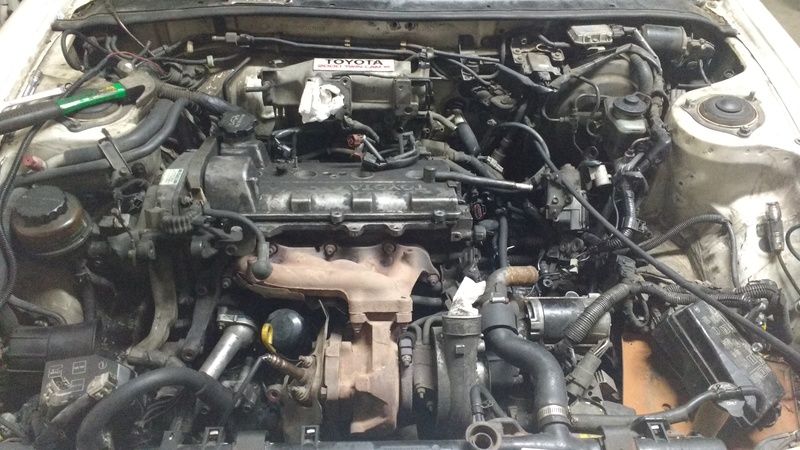

So, Pulled off the hood so it was easier to reach things and I didn't keep hitting my head on it. Pulled the plug wires only to find all but cylinder 1 covered in oil. Pulled the plugs and they were very burnt and old, had some oil of course on the threads too. Engine is very dirty, oil leaking slowly even though the cars never been turned on in my garage on the floor. Pulled the distributor/cap/rotor/ out removed the throttle body, EGR and cruise. Finally was able to get the valve cover off. As you can see if you look really close the oil has what seems to be coolant mixed in with it. Looks like a dark milkshake, like coffee color and it smells bad like burnt oil.
Other observations...
Opened the radiator cap only to smell what seems to be gas :doh:.
Played with the turbo :P seems to have no shaft play at all that I can tell up/down or left/right but it spins freely.
Pics show the wires covered in oil, and what the head looks like with the VC removed. Any thoughts as to what else this could be if not a Head gasket?? I'm thinking at 212K miles, its worth the time I have off of school to just remove the head, get it tested, cleaned, and adjusted, replace all the belts and hoses and gasket I can then slap it back together and crank it up.

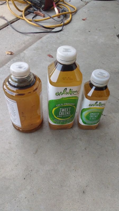

SO... decided to devote some time this week after work (2-3) hours a night to get this head removed. Last night I drained the oil (rather the coffee) and drained the radiator. The coolant looked like Flint tap water :crazy: I think the kid before be just kept throwing water and not coolant in the car and it started to rust a little. Removed the EGR only to find it has broken off at the connection to the head :pissed:. Removed the coolant neck and hoses attached, removed the strut brace, and removed the cold start injector line. Next is to remove the intake manifold, timing belt cover, timing tensioner and Timing belt. Maybe tomorrow I can start working on the turbo and exhaust manifold.

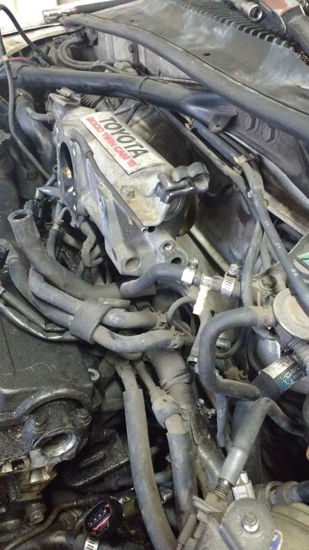

EGR removed
EGR :/

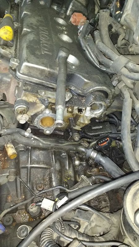

Coolant neck removed.

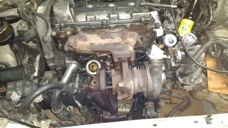

Removed the alternator and belt, the turbo cover, battery, and started to remove the fuel filter and now its not coming off. Looks original so might take a while. Next will be the turbo and intake manifold.

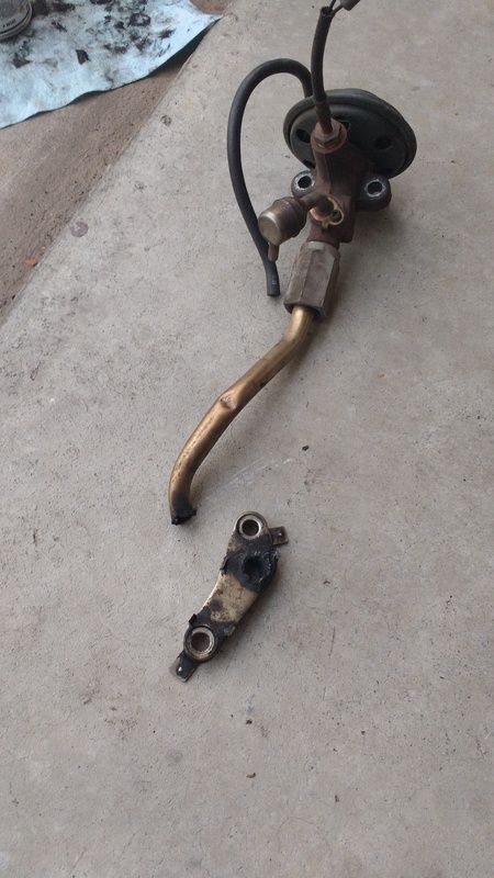

Last night, removed the alternator bracket, the engine hook, coolant upper and lower hose, and the radiator. Started on the downpipe (stock first cat) and realized the oil cooler/filter mount thingy is in the way :pissed:. spent 30 minutes trying to take the rest of the turbo and manifold off with no luck. Called it a night at 11:07.

The rust colored coolant is probably more from very diluted Toyota red than rust, judging by what I can see of the engine.
