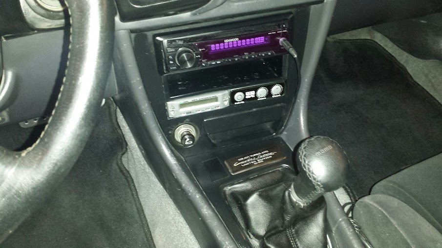

So I got my goodies installed...
new CS plaque #361 of 5000
It fits nicely

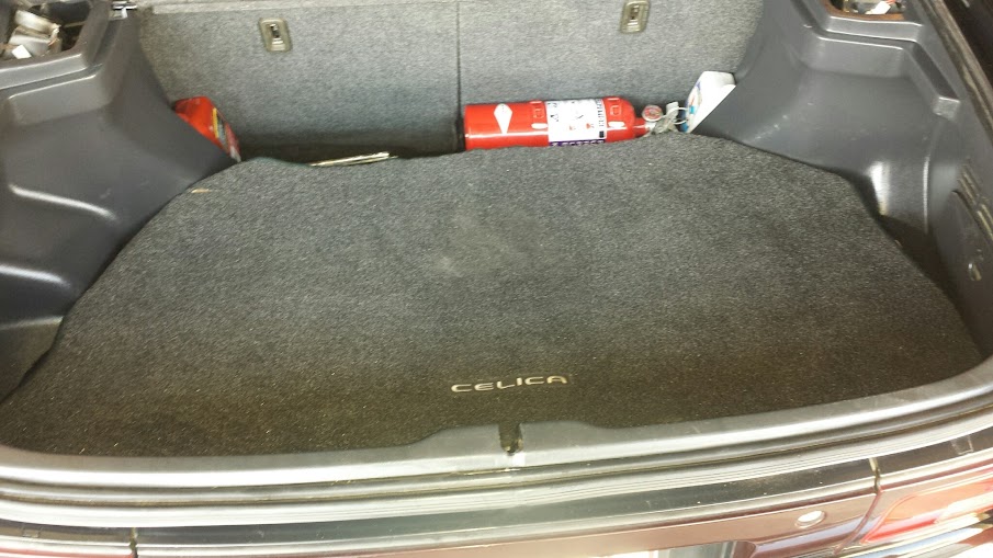

new trunk mat. It doesn't quite fit but it looks good.
