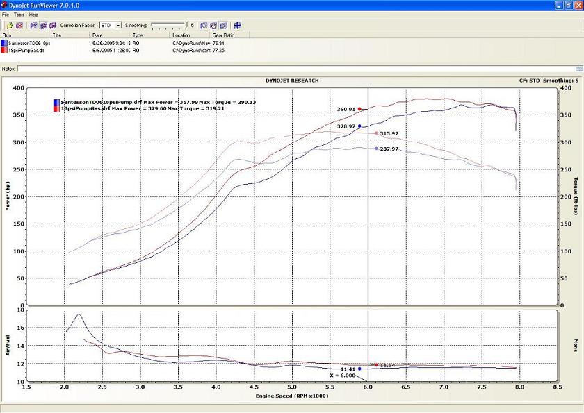

Postby KORacing » Tue Mar 21, 2006 6:22 am
I've been extremely happy with the results we've achieved with David's car. Another thing to keep in mind when looking at David's dyno run is that it was in 3rd gear, and typically, I see 200-300 rpm better spool between 3rd and 4th. The tune I have helped David with is conservative in order to not blow anything up. His open downpipe run shows approximately 150 rpm better spool than through the exhaust, and the power was achieved at almost 2psi less boost (360 front-whp).
For someone who asked, here is a plot of ATS's TD 06 vs. the SB46 on the same car (MR2) both running 18psi on pump gas (built 2.2L EngineLogics stroker, cams, 70mm throttle body, greddy side-mount IC): Image.
