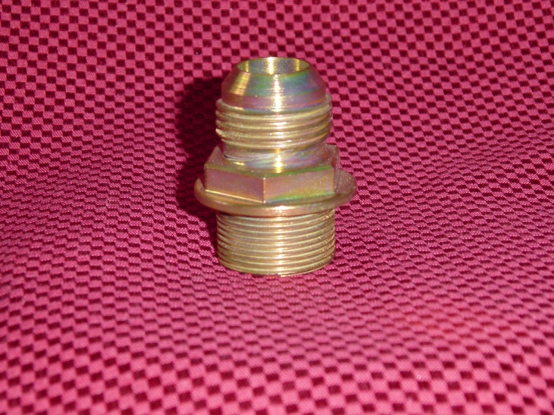

Ok so my stock oil return 90 hose is leaking. I am going to switch it to a ss braided line. there are some parts on e-bay and the adapter on koracing there also some parts on frozen boost.com. can some one who has done this mod chime in for me? I need to do this, but it needs to be on a budget.
http://www.frozenboost.com/index.php?cP ... dc8ccdca1a
http://www.koracing.net/viewproduct.php ... roduct=240
http://www.ebay.com/itm/180984190632?ss ... 1438.l2649
http://www.ebay.com/itm/380478247313?ss ... 1438.l2648
http://www.ebay.com/itm/180984193668?ss ... 1438.l2648
I was thinking of getting
and
and getting the adapters to go from the -10an to -12an
what do you guys think? im looking to spend around $70 usd total.

the problem is that i only see the oil pan adapter on ko's site. im looking at getting parts from a few places in order to build my kit. maybe ill just get the adapters and have my local custom hose shop build the rest.

Mine was made with various parts , from ebay , to ko racing , to having the drain made by a local speed shop. Many ways to do it. best setup IMO is get the stock feed adapted to AN , AN stainless feed line to adaptor at turbo , then drain side SS line to adaptors at pan ...

so this is what i ended up doing.

Dont know where I was getting the idea that you were tapping into the oil pressure switch but ....
Only concern I have is if the hose is rated for use with oil??? Looks good regardless

Postby jaydog82 » Thu Jan 24, 2013 10:30 pm
oh yes the Teflon line is rated for oil and fuel and temps over 400 degrees.

Postby 88gt4DE » Fri Jan 25, 2013 1:47 pm
Nice work , I like that 8)
Re: stock st165 ct26 ss braided oil return line
Postby 801Alltrac » Tue Feb 26, 2013 3:35 am
x2 looks great how much did you spend?

Postby jaydog82 » Tue Feb 26, 2013 5:21 am
i spent about $110usd, if anyone is interested i could have these made for $130 shipped plus your core pieces.
