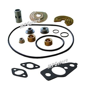

I found the other bearing on the floor...must have fallen out when I took it apart. So now the bearing situation is good but still the thrust spacer(number 9 in diagram) does not look right to me. It is suppose to have a oil deflector, correct(part between 6 and 7 in diagram)? Is it even necessary? Also number 8 in the diagram doesn't look like it is in the kit.
Here is a diagram of the ct20/26:
Here is a picture of the kit:

Postby Theman88b » Wed Oct 30, 2013 7:59 pm
Yeah I am doing some more searching and some kits come with the oil deflector and some do not. Possibly this is why the turbo failed prematurely, so I definitely want it in there. Part number 8 is still not included in these kits, looks like it is pressed in to number 9. Anywhere in particular I could source this? The kits I found were on eBay mostly. Thanks for all of your assistance.
