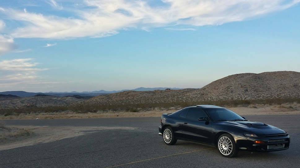

I got these to fit up 17x7.5 48 offset with a set of 215/40/17 tires. I put a rear 25mm spacer on in the rear.
They fit great the front does not rub, but it is about 13mm (35 to 48 offset) back in the fender and closer to the strut.
I think it would look a little better with a pair of 10mm spacers in the front, but it fits fine now.
