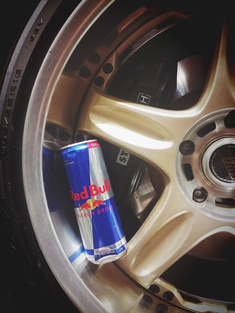

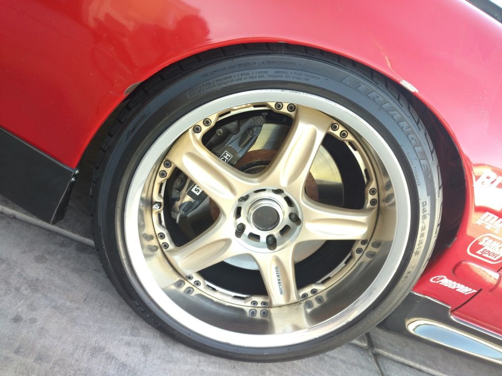

Thought this was relevant.
18x10+12 square 265/35
No spacers here.

Postby soarer.jzz30 » Fri Jun 17, 2016 7:42 pm
So far I've got full lockout and no rub at all, took awhile to adjust and roll/pull the fenders to make it work,
As mentioned before they are ;
18x10 (+12)
It isn't lowered much tbh, maybe 2 inches so everything sits nice.
I will likely go 245/40 next set of tires so I can get another inch drop.
On some trash Chinese tires atm just to get the fit right and while it sits waiting for another swap I figure I'd get it closer to done.
