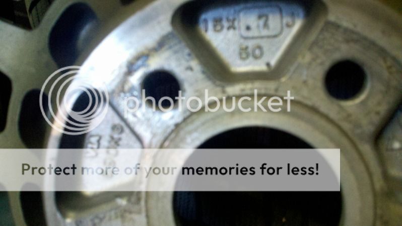

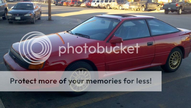

Well, I am wanting to install my spare Enkei RC-G4 rims onto my ST165.
Here are the rims specs: 15x7 et50
Without spacers the car cannot drive as the tires slightly rub against the strut tubes. Here is how it looks on the car though:
What is the proper spacer that is needed to properly fit these rims? I should note, I'm not the biggest fan of spacers- but this isn't a race car. Should be fine for general street use.
