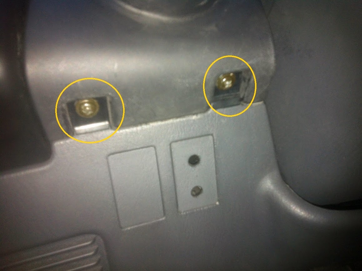

Step 1 - Begin by removing the two screws to the left of the steering column.

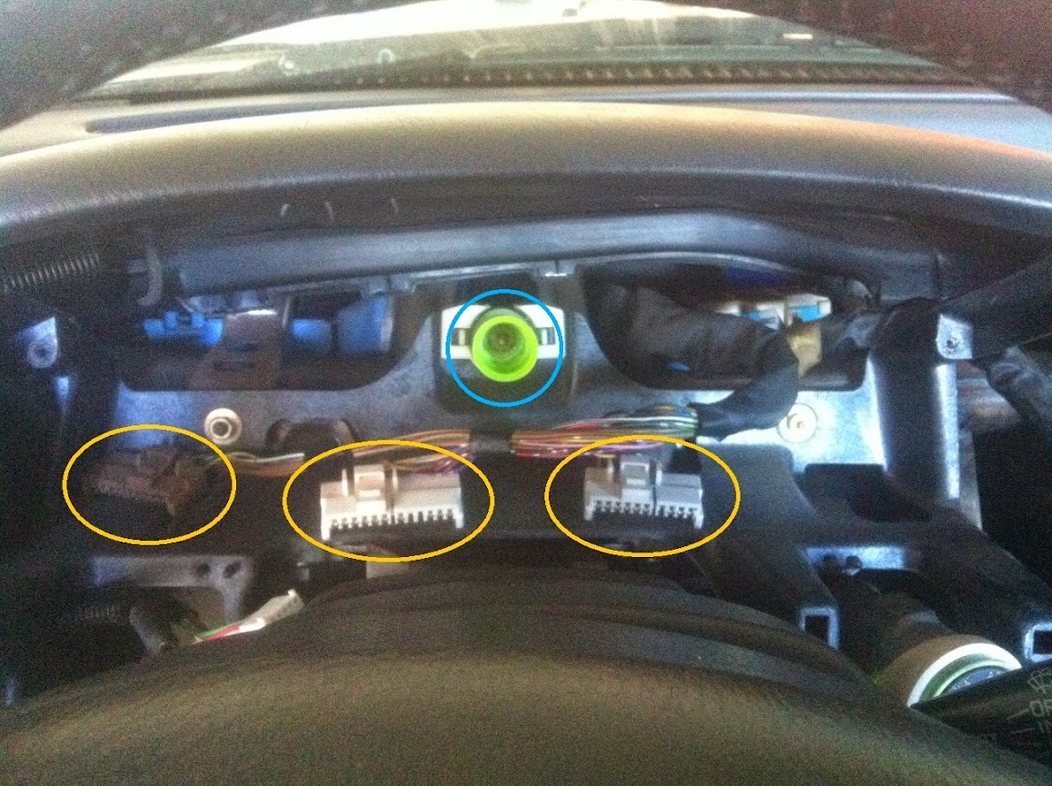

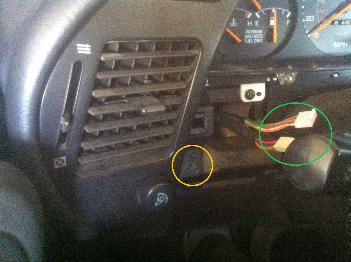

Step 6 - To the left side I disconnected the plugs for the interior backlight dimming switch, and the fog light switch.
Step 7 - This allowed me to pull the trim piece out from behind the steering wheel, rotate it and lay it as shown while still connected to the electrical harness. Here it is out of the way and you can move on to removing the gauge cluster itself.

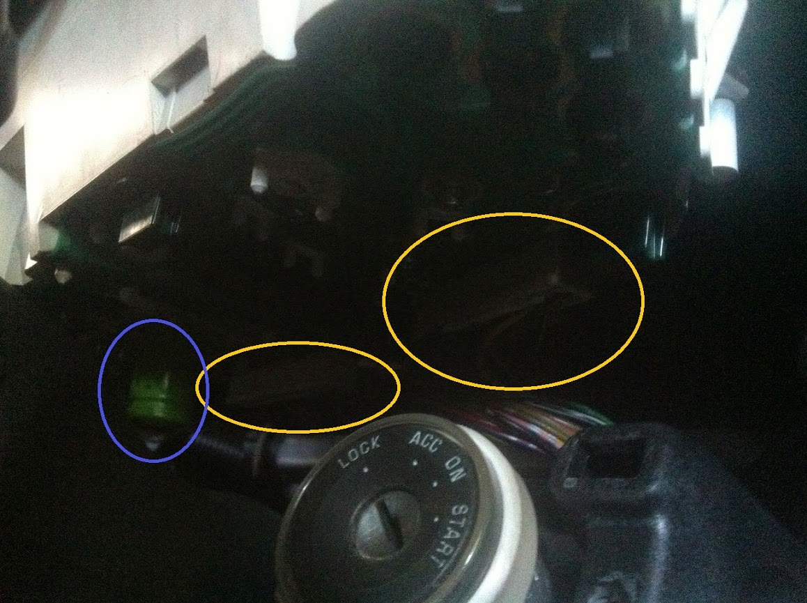

Step 9 - Gently pull the cluster towards you, and as you do so begin to tilt it so the gauge faces aim up. The object circled in blue connects for the speedo and should have disengaged on it's own from the mating part attached to the car. There are three electrical clips that need to be removed, and the release tab on them is large and easy to operate with no guesswork. Two of these electrical clips are circled, the third is to the left of the speedo port but is not visible in the picture.
Step 10 - You can now remove the gauge cluster. Here you can see the speedo connector, and the three electrical connectors you just removed.

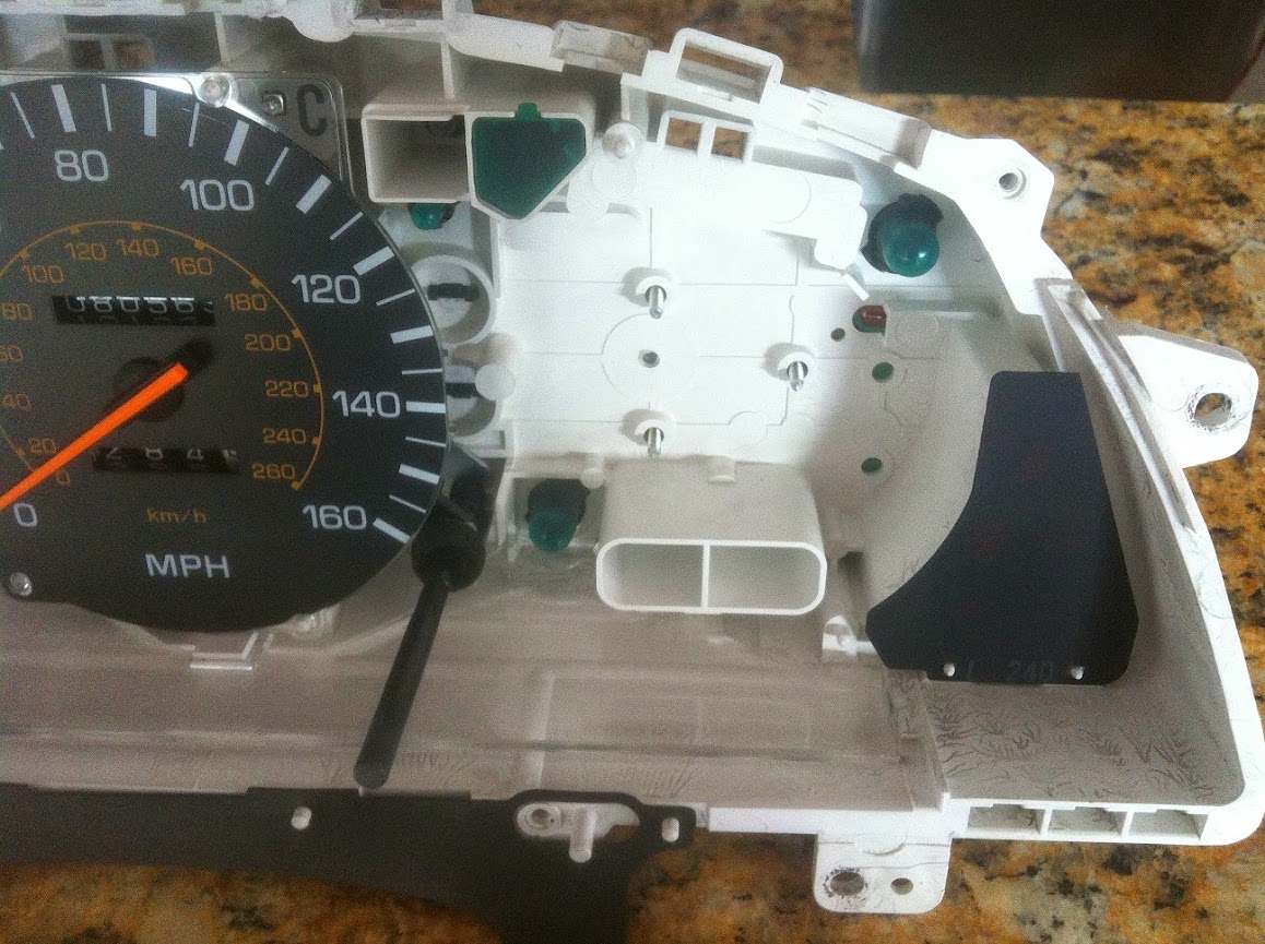

Your gauges should now appear like this.

Step 15 - You will need to remove the gauge needle, and I stress this highly, VERY CAREFULLY. The needle slides over a small cylinder as you can see pictured below and indicated with the yellow arrow. I used a small flat head screw driver to gently put even force from the arrow side until I was able to slide the needle up and off. DO NOT pull on the needle extremities as it will most likely break off. If you must pull, pull evenly from the center hub of the plastic needle.
Victory will look something like this.
