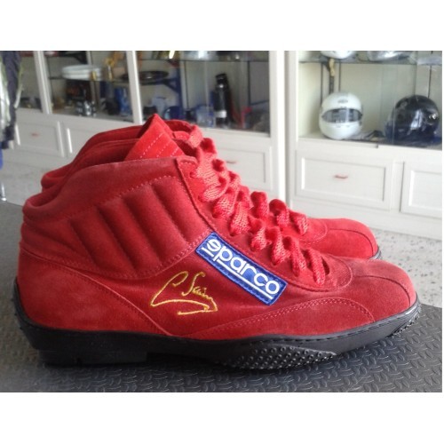

Re: My 1990 Celica GT Four (RC Conversion)
I found a pair of sparco CS shoes in my search to find the end of the internet.
