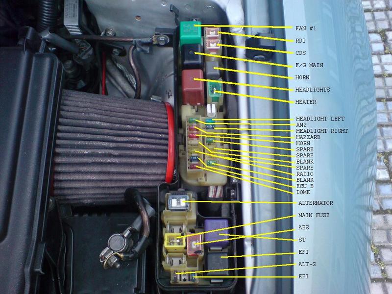

Just had my stereo clock and fan all go AWOL at the same time. Not being particularly adept when it comes to ST205 electrics could anyone give me a rough idea as to where the problem may lie or what areas to check first? Thanks.

I have no idea of the similarities (if any) but my AT200 had a similar problem once, IIRC the radio/cig lighter/clock are one the same circuit. . . Fan I am unsure of. Check the fuse box in the engine bay (if it's similar to my old non GT4) for a blown ~20amp I believe.
Edit: After Google imaging 205 bays, the fuse boxes look the same. Found this one and the fuse does appear to be a 20amp
