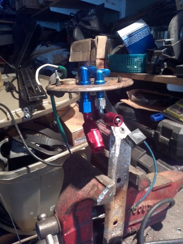

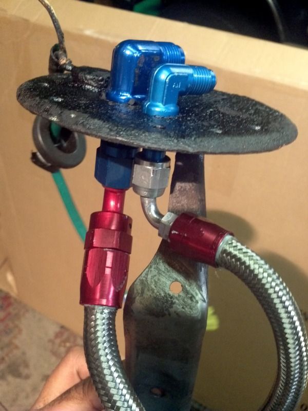

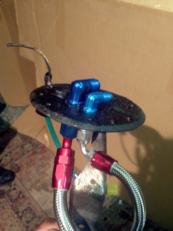

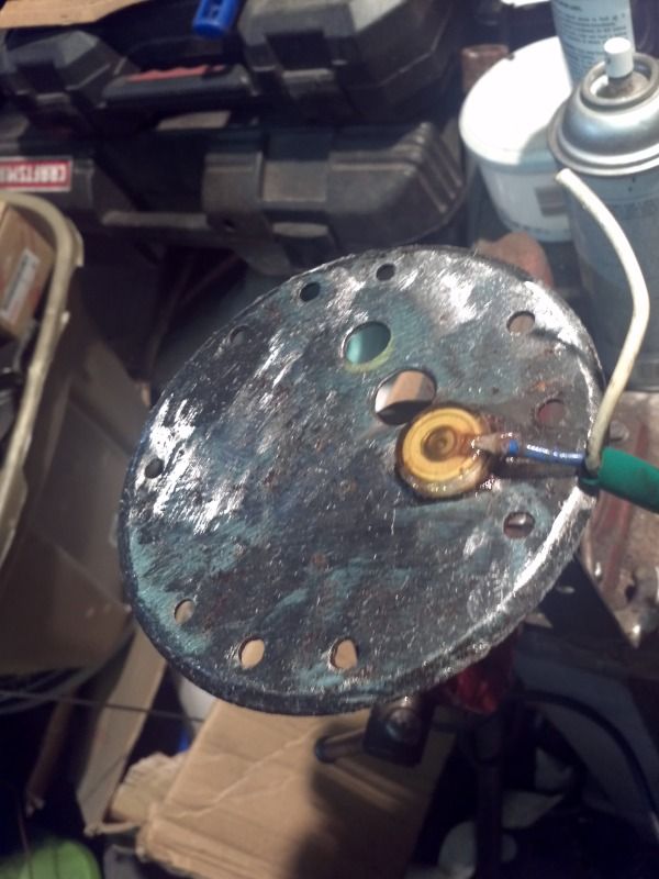

We are one step closer to getting this thing to run. We restored the fuel pump bracket and got rid of those crappy lines and replaced them with SS lines.
Before
Mocking everything up
light sanding and phosphoric acid bath
Rust Coating, pump and lines installed
Before
