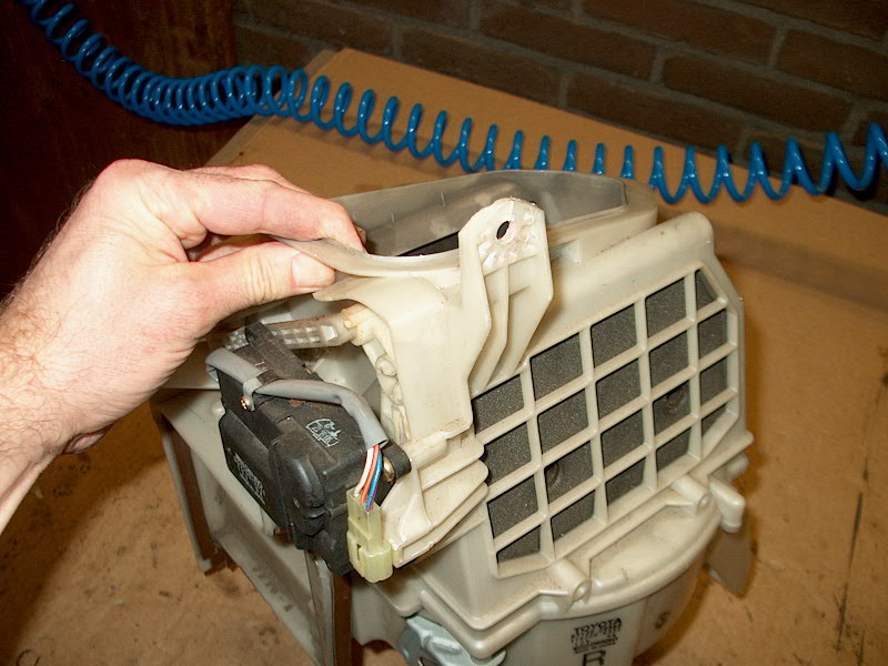

Took out the fanhousing this weekend. This because I was still struggeling with cold air entering the cabin somewhere around this housing.
Removing is an challenge because the most top bolt is behind the dash and an heating vent pipe. Anyway, after some nasty words and lots of sweat, I managed to remove this housing.
There are two large outlets, what are opened as soon as you choose to close the outside incoming air. The fabric what is sitting on this doors is gone after 30 years. Hmmm, can happen. But, since I have never used this function in the 28 years I own the car, I decided to block this vents permanent. If I am going to regret this, I can always remove the housing again and make some doors that seal good. For now I am going to test this.
Installed the housing this evening, PITA too, of course.
Anyway, some pictures from the housing before I blocked the vents. The big one is attachable from the passenger seat. But the other vent is facing the firewall and is impossible to block without removing the housing.

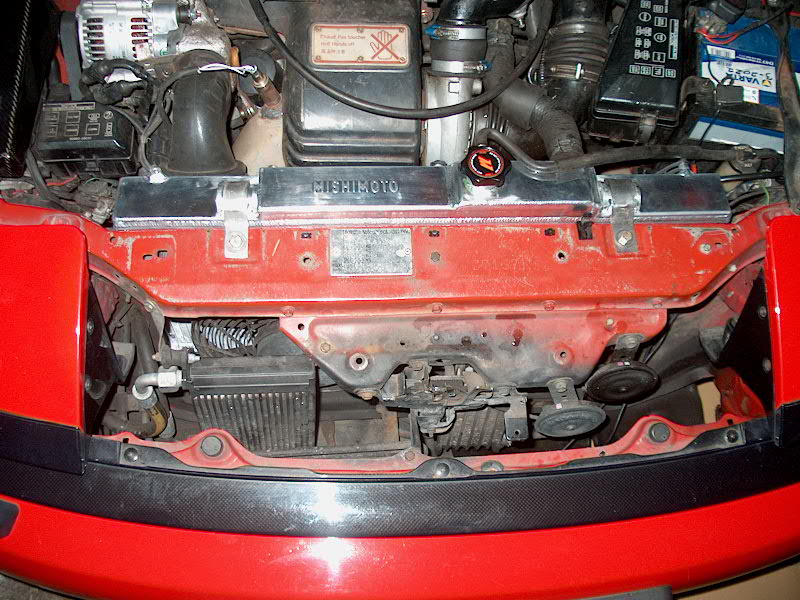

Cooling problems.
The 20 year old tripple pass Ron Davis radiator is leaking.
At the same time I saw that the TRD thermostat is stuck too, no good.
After a long ride, the next morning, there is a lot off coolant on the floor below the radiator. Perhaps the rad cap too, dunno.
Anyway, got myself an Mishimoto radiator (# MMRAD-CEL-89) and an Mishimoto thermostat (# MMTS-TC-05L). The TRD was 71°C and the Mischimoto is 68°C. But that is no problem, I can make changes for the fans in the Autronic, if needed.
The Mishimoto radiator is equiped with an new 1,3 bar rad cap, so that is nice too. My old cap was an 1,3 bar TRD cap.
Just find me some time to install the stuff. The car is at the painter now, due to some rust behind the left front wheel.

In the mean time I swapped the thermostat for the new Mishimoto one and make me some radiator brackets, since the old ones were modified for the Ron Davis radiator.
BTW, the Ron Davis radiator is een tripple pass radiator but the Mishimoto is much thicker. I really doubt if the stock fan is fitting between the rad and the rest off the engine?
For me not important, the stock fan is about 10 cm thick but my new Spal fan is about 6 cm. That should work.

Made custom brackets for the Spal to fit the Mishimoto. Works good now. Installed in the car and fired her up last evening. Fans did work and no leakage, looks good.
Now reinstall the other parts and she should be good.
Gert
Member
She is in the car, mounts are made, coolant filled and tested, no time for an decent test drive yet.
The top hose needed to be cut off about 1 or 2 cm.
The Mishimoto is much thicker than the old Ron Davis radiator and with the stock length there was an nasty bent in the hose. Bottom hose is long enough and needed no adjustments.
