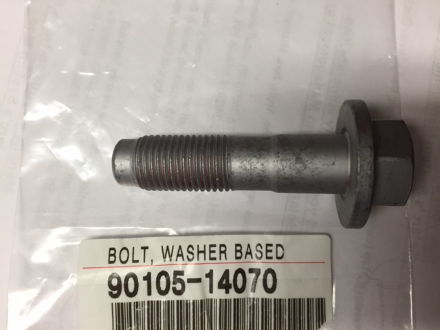

hey i am finishing up a st205 swap in my st165 and it is missing the bolts that hold the side to side crossmember. Toyota says they are discontinued, are they the same as the strut to hub mount 19mm bolts? are they longer or shorter? I think the parts description describes them as M14x1.5 and i tried the strut bolts but they dont seem to want to start threading. If anyone has a picture of what they look like, that would be a big help, thanks.

The part number for the ST165 bolt is discontinued:
90101-14028
It lists the dimensions as: *14-1.5PX54-27
I think you can use the bolt for the AT180/ST18*. The bolt is M14x1.5 thread, 54mm long, and threaded for the first 27mm. This matches the dimensions listed for the discontinued ST165 bolt.
Here's a photo of the ST185 bolt and part number.

Also, the bolts that connect the strut to the steering knuckle are M17, so they definitely won't thread in.

The bolt is the same for all trim levels of ST16x, so if there are any in junkyards near you that's an option.

thanks for the help guys, you were right i found a 87 celica and it had the same bolts!
