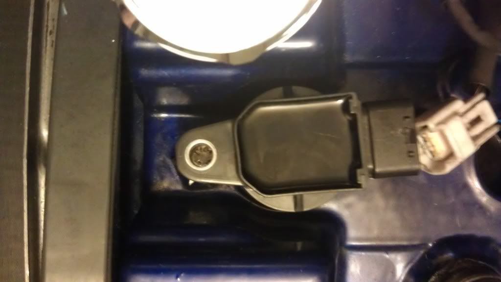

l0ch0w wrote:Trevor, are your COPs running through some sort of CDI controller? If so which one?
I'm currently running an MSD DIS-4 plus HO
In other news, looks like I might be seeing what I can do with a set of Yaris/Prius COPs if they are as good as I've been led to believe they are... Looks like they might just work, fitment wise... :smokes:

Postby l0ch0w » Fri Jan 27, 2012 5:07 pm
I just dont know of any COP based coils that can take more than 2 or 3 ms of dwell...
Dwell time for the most part = spark power. The more dwell a coil can handle, the more power it can push out. Its entirely a function of inductance load on the primary windings to be fed to the secondary windings. At some point you reach the limits of physics... The drawbacks to coils that can handle more dwell time is that they also have cooling issues. Beyond a certain point, 8-10ms or so, it can also start to effect maximum rpm. Do you know what the dwell time is on these yaris coils I think its 3ms but im not sure? If its still only 2 or 3 ms max then I dont think its going to solve your breakup problems. I know I keep pushing them... but the lq9 coils handle up to 6ms of dwell, and are internally controlled, so even if you mess up and set the dwell to 10ms it will internally regulate to 6 and run just as cool.
Ethanol and q16 require stronger sparks to light off correctly than does standard pump gas, which means if you want to run those fuels you are going to need to be able to light them off at 9000+ RPM. Flex fuel vehicles typically have a spark plug gap of .050 or greater just for reference. What is your plug gap?
AEM and a few other companies have CDI based coil on plugs, and while CDI can run very well, if you ever plan on ever driving it on the street, you basically need to buy two of them. They are still so highly unreliable that few get more than a thousand miles out of the controller before it shits the bed. I know you want the clean look of coil on plug, but it may be inevitable that you will have to go with external coil packs...
Hopefully these yaris coils can do the trick, although I cant imagine they are much different than the 1zz COPs...

l0ch0w wrote:I just dont know of any COP based coils that can take more than 2 or 3 ms of dwell...
From the first hand experience, 2.4ms of dwell, 2L 16V engine, 10:1 comp ratio.
2.7bar of boost from 9180 efr
No breakup on 9000 on straight meth, 4400cc of injection per cylinder.

Postby l0ch0w » Sat Jan 28, 2012 2:55 pm
^Same here...
I like overbuilding things myself and 2.3ms on meth with 40psi just seems awful weak for such a high powered car. Ignition strength = hp, why not capitalize on that?
I would wager that you would have breakup if u pulled your gap up to .045 inches... Just sayin
The point I was trying to make is that coils that can't handle more than 3ms of dwell need to use a smaller gap. It's common sense that charging a coil that can store more spark energy will take longer. If you over charge a coil that can't take the longer dwell times out will simply overheat...
Im comfortable with 50 thousandths gap on my coils... Are you?
Andrew

If you buy a quality cdi box like the autronic 500r or M&W it will not die. ( from my experience, msd cdi boxes WILL die at some point! and i will never buy one again.. )

Postby l0ch0w » Sat Jan 28, 2012 10:34 pm
sleeper wrote:If you buy a quality cdi box like the autronic 500r or M&W it will not die. ( from my experience, msd cdi boxes WILL die at some point! and i will never buy one again.. )
So you fancy the $1000-1500 price tag on those units too???
Im cool with $50 for a set of used lq9 coils thanks...
Im all about paying to play and doing things the right way, but the price differential here is just too much IMO for whatever the small benifits to it might be...
At least my $1500 standalone and my $2000 turbo kit can get me to 500whp I just cannot justify buying a $1000 box that "might" help me eek out another pony or two over a system that in comparison is almost free...
At any rate, If others have had no issue with this kind of ignition system with this fuel, at those power levels and boost levels, I would imagine its time for you to pull your plugs out and read them so that we can stop speculating about what this could be...
