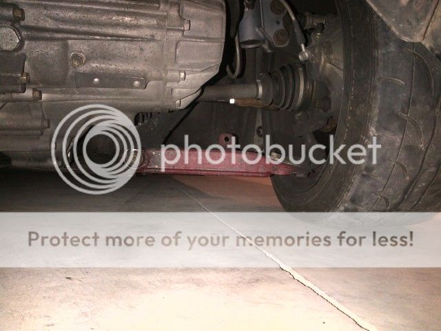

Good points Luke. My car has probably more front end weight percentage than the alltrac because I am missing a driveshaft, rear diff, subframe, axles, etc. Just because I corner balance my car doesn't mean I have equal weight distribution to all 4 corners. The reality is, it's near impossible to get the weight off the front end of a FF car.
Its completely up to the car owner whether or not they want to make their own roll center adjusters, or trust their abilities to make a part that could fail. But Martin used these on his Alltrac, and I've been using them for 2 years now with no issues. Comparing these to a stock ball joint will make it apparent that they are quite strong. The make the OEM balljoint look tiny. The thought has never even crossed my mind about having one of these fail, and I have no reason to think so.

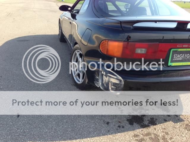

As for work on the car over the winter, the big thing is going to be paint. At a practice day before the last event of the season, I broke a rear control arm and it turned the car hard to the right. I managed to bounce the car off the wall, but keep the damage to a minimum. The car just needs a quick pull to get the body panels all lined up again, and then it'll be painted. It only bent slightly behind the rear wheels, so nothing is structural. The damage is purely cosmetic.
I don't want to have anything break again, so I am going to re-do the rear suspension. This time, using 1-1/4" aluminum radius rod, oppose to the 3/4" stuff that I had on there before. I believe that the arm broke strictly from fatigue. It is 16" long, and relatively small tube so I imagine it was flexing and finally after 2 years of abuse, something had to give. I'll be keeping an eye on the new stuff to ensure we don't have an incident like this again.
