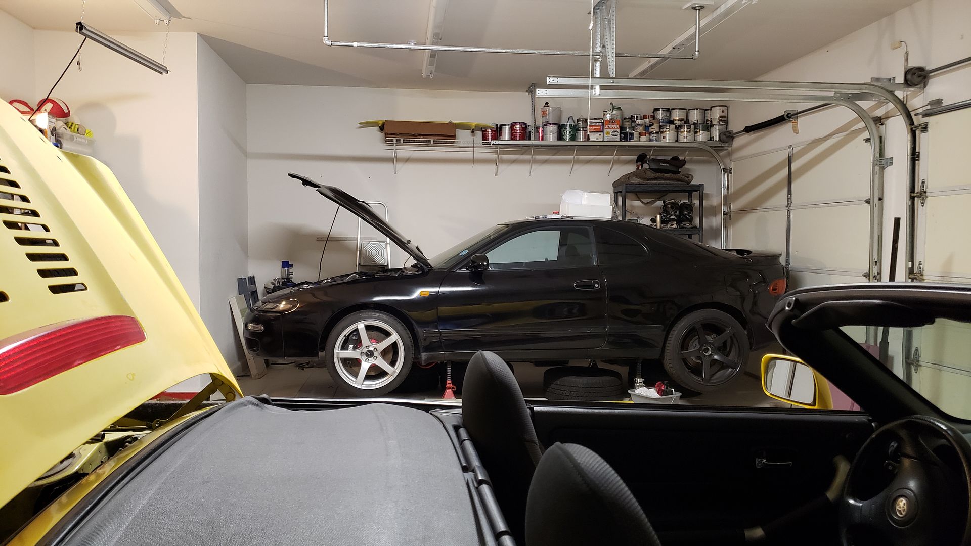

Postby psipwrd » Sat Jun 06, 2020 7:26 pm
The project is still alive! I've relocated to Las Vegas, dropped the car off at a shop for some tweaks and a tune and some parts went missing. I got the car back in my possession and started working on it myself. The wiring is a nightmare!
