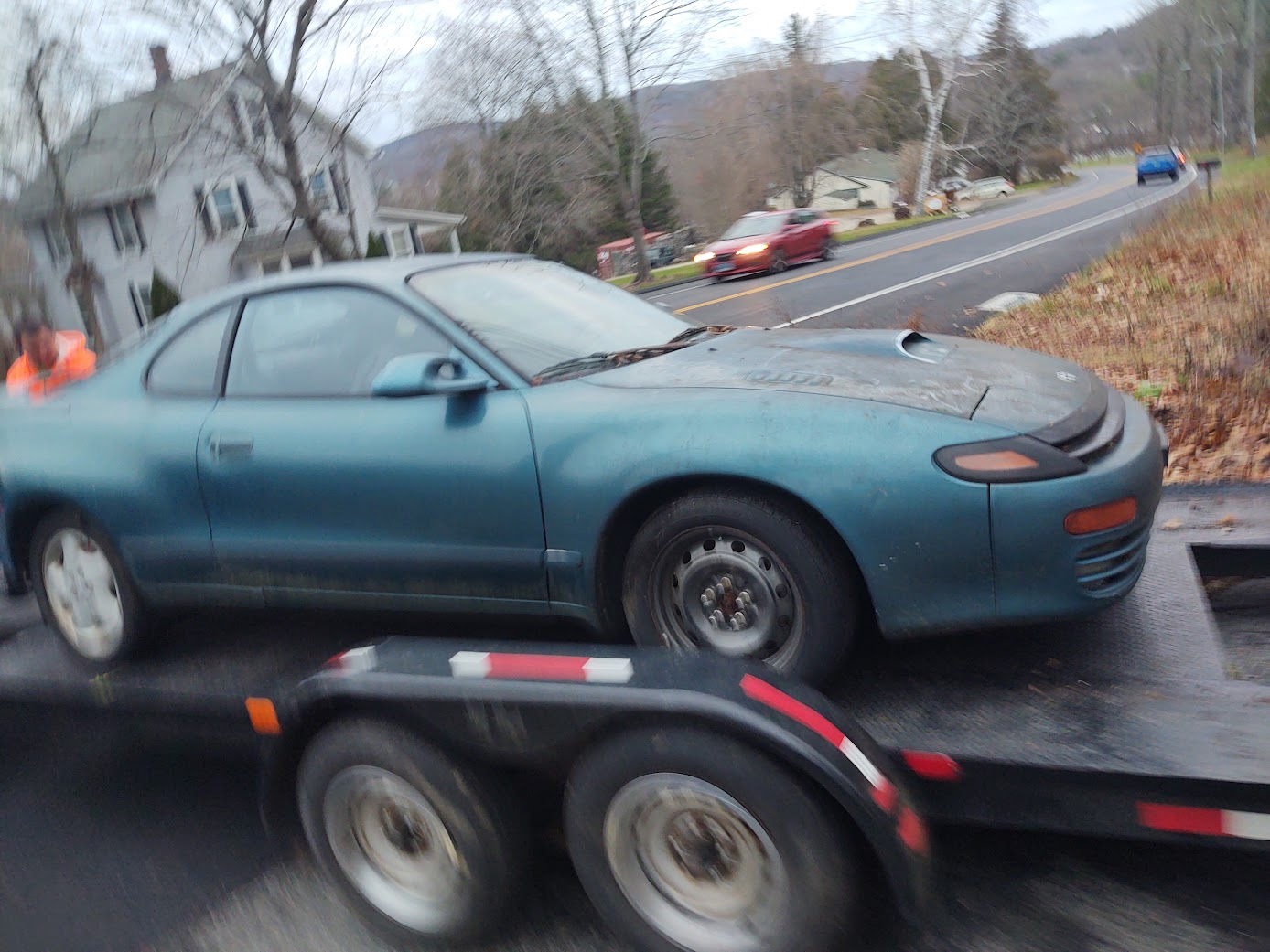

On the trailer we go. A buddy of mine and the previous owner discussing ways to do it... it was very much a part of the earth:
On the trailer, took a bunch of work with the winch... all tires were frozen:
Off we go:
When I got it home:
More detail a year and a half later when picking it up:
Off we go:
When I got it home:

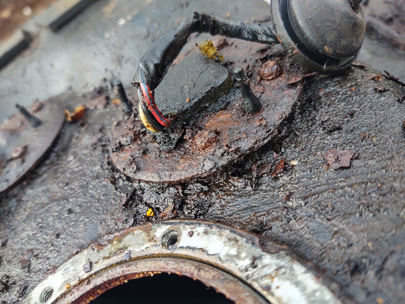

And now for some actual work. After trying to jump +B to FP with no success and then testing the FP / sending unit with a VM, it was pretty easy to determine everything in the tank was toast (as previously confirmed via suspicion by Tecker185). I decided during this unnaturally warm mid-december day in the northeast to pull the tank. Here we go:
not looking good
chipmunks living rent free smh
look at all this room for activities
pretty clean actually, i'm surprised!
this was not so clean, man these were not fun to get out
oof this aint ganna be easy to find
these were even harder to get out lol
Anyways, after draining all the gas and doing my best to clean the tank, it was surprisingly decent inside. Although there was a good amount of really, really, reallyreallyreallyreally old gas caked in the bottom it wasn't as bad as i thought it would be. Anyways, might as well upgrade the FP with a Supra one however if anybody has any ideas to further clean out the fuel tank without damaging it, would be awesome. Also, if anybody has a fuel pump assembly and sending unit that would be greeeeat.
not looking good

Re: Project Lazarus: Pulled from the Ground; Save from the G
lol oops, how about now?
If anyone happens to have an extra fuel pump hanger and sending unit, keep me posted. Might as well toss in a Supra TT fuel pump.

Works now. Chassis doesn't look too rotted out yet...? - I left both mine in parts car, too rotted. You can get new units from overseas.

My fuel pump sender was worse than that. Soaked it in rust remover for a week with some pipe cleaning and it is pretty much restored. Stupid rubber bumper below fuel pump is like $30 from toyota. Each gasket is about $10
Oh and I spent $350 to have the fuel tank flushed and restored. Doing it myself would have been anything but environmentaly friendly. Old gas and rust is some nasty stuff.

abeans wrote:Works now. Chassis doesn't look too rotted out yet...? - I left both mine in parts car, too rotted. You can get new units from overseas.
https://gt4-play.co.uk/shop/
Tecker told me the same thing, I have the filler neck, hanger and vent tube in my cart... but am waiting to see what soaking does. The snow isn't going to let up for a few months now, so I have some time!
simple wrote:My fuel pump sender was worse than that. Soaked it in rust remover for a week with some pipe cleaning and it is pretty much restored. Stupid rubber bumper below fuel pump is like $30 from toyota. Each gasket is about $10
Oh and I spent $350 to have the fuel tank flushed and restored. Doing it myself would have been anything but environmentally friendly. Old gas and rust is some nasty stuff.
Good to know, I do have everything soaking now as well. As for the tank, that's quite expensive but it makes sense. The outside of my tank is in surprisingly good condition. The inside has A LOT of residue but very little rust. Thankfully it had some really old gas in it that hadn't completely turned. I cleaned some of it out but I plan on using acetone. Any objections to that?
