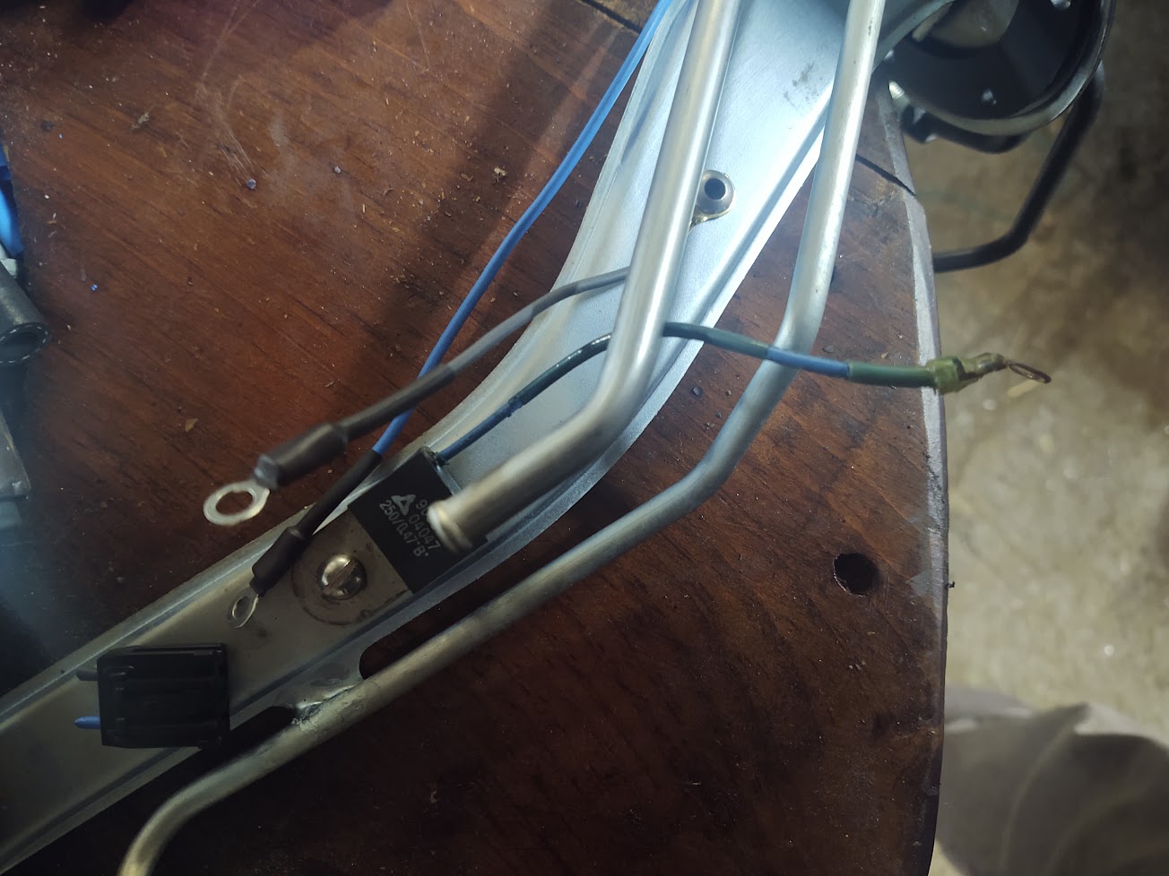

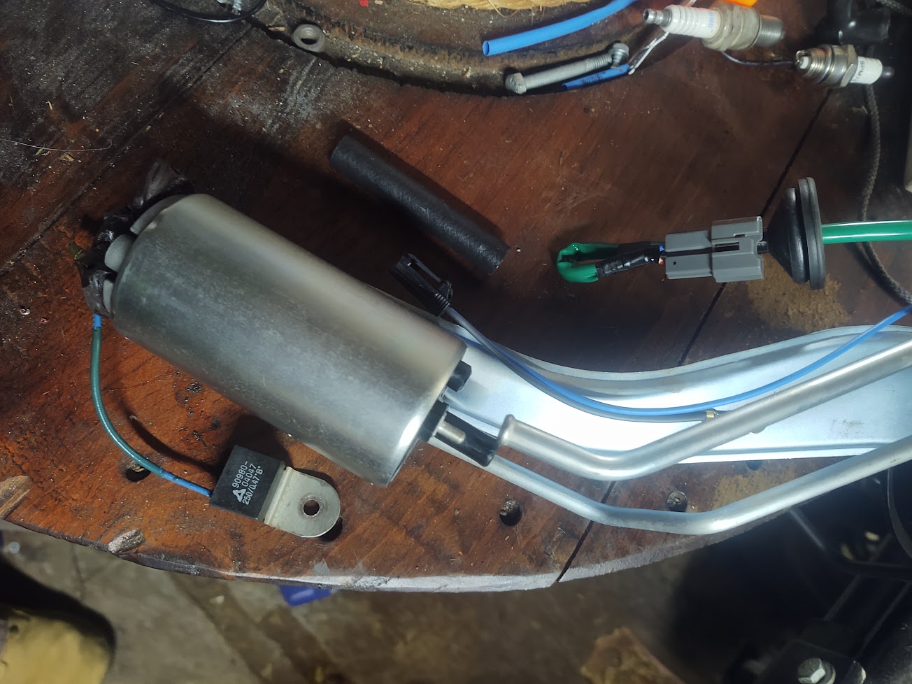

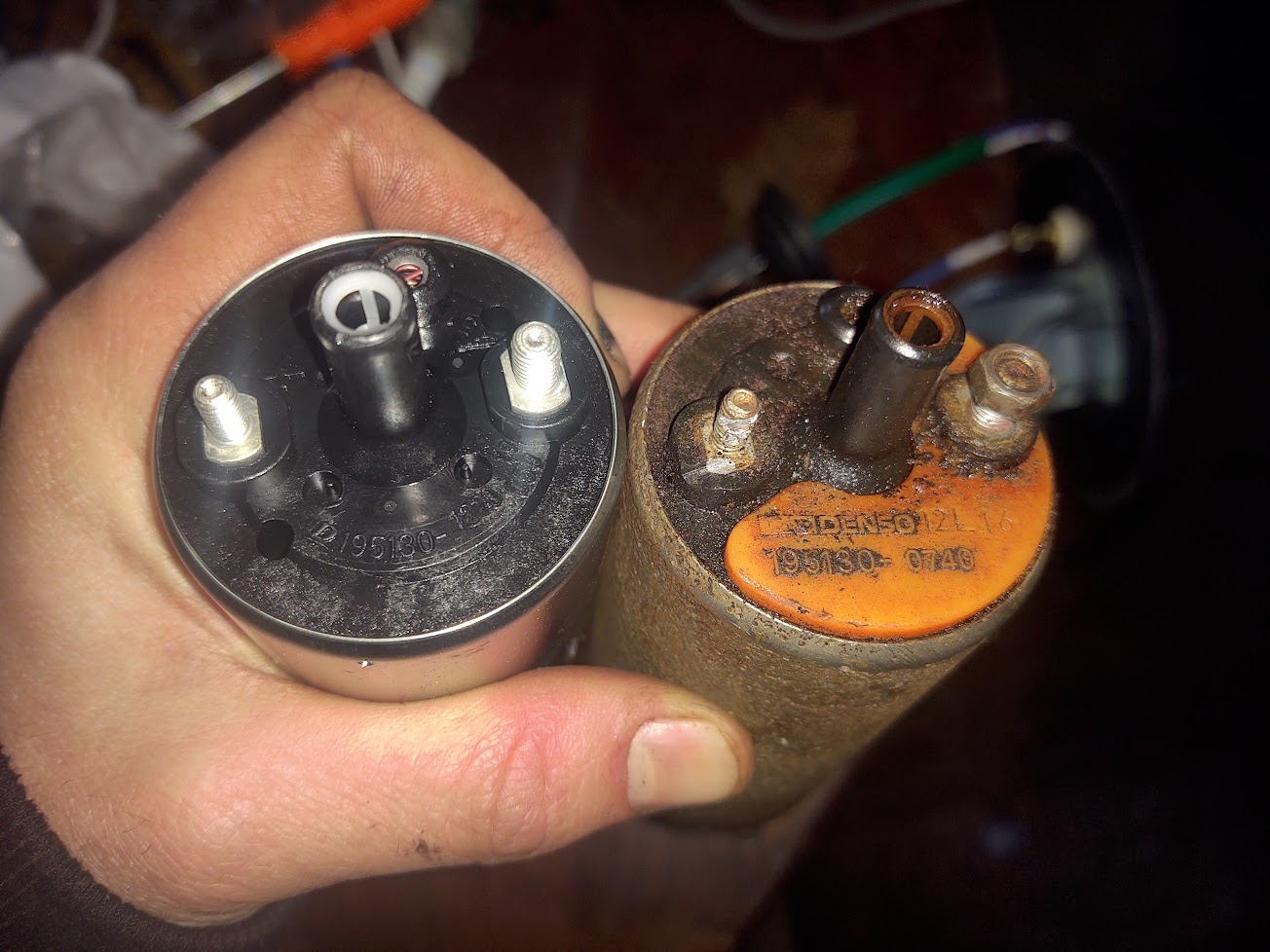

Apparently my new hanger didn't come with a fuel pump condenser/suppressor on it... maybe the GT4 and alltrac had a different setup? Anyways, that's the old one and here's the new one:
My question is this: is it necessary to hook it back up or can I bypass it? Here's the part number:
90980-04047
or
90980-04061
It's also noted I'm upgrading to a Supra 951-0014 fuel pump. Any additional info I need to know before I start cutting wires?

Re: Project Lazarus: Pulled from the Ground; Save from the G
I believe the Fuel Pump Bracket you purchased from GT4-Play is actually the part # that corresponds to an ST205.
I had looked into this recently e-mailing back and forth with GT4-Play. The part they are selling is Genuine Toyota OEM 23206-74760, which according to toyodiy corresponds to the ST205, but not the ST185.
The Genuine Toyota OEM part # for the ST185 Fuel Pump Bracket is 23206-74540, which is no longer available.
According to GT4-Play the ST205 part # 23206-74760 is compatible with the ST185, but as you are observing, does not come with a suppressor.
If the replacement fuel pump you will be using is no longer the Toyota OEM ST185 Fuel Pump, perhaps you no longer need the suppressor? (would recommend checking the Toyota OEM wiring connections for the Supra fuel pump you will be using). Or maybe it would still be desirable to use the suppressor as the Toyota OEM ST185 ECU is assuming one is installed?
I have never touched the fuel pump in my ST185 so I don't have a solid basis for any advice, just thought I would point out why the suppressor was not included on the ST205 fuel pump bracket you purchased.

jr32 wrote:I would also send your question directly to GT4-Play and see what they recommend.
I spoke with them, they said this:
"Hi Tippo, Good to hear all has arrived.
From what we hear people don’t reuse the suppressor from the 185 hangar. Unfortunately the dedicated st185 hangars are No Longer Available, the same as the breather tubes and sender units i'm afraid
We have tried to order more breathers so there is a small chance we may get the last of them, if we do I will be sure to notify you.
Regards"
So that's what they said about the suppressor. As for the breathers, they don't even have anymore of those coming in!

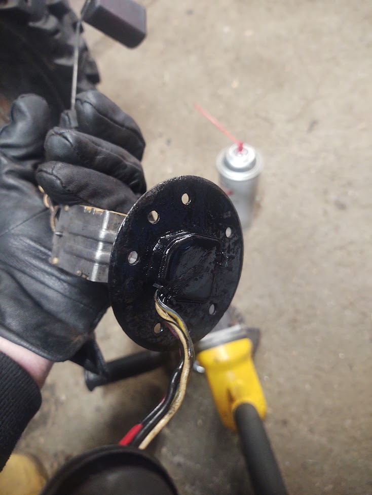

Also, a bit of an update on the car. I re-soaked the sending unit, old hanger, vent tube and whatever else I could get into another gallon of PB.

sending unit as clean as i could possibly get it:
onto the fuel pump hanger. supra fuel pump and suppressor going in
supra fuel pump vs alltrac fuel pump
suppressor on with stainless steel bolt / nut
wiring done
everything installed... purrrty
wiring done
