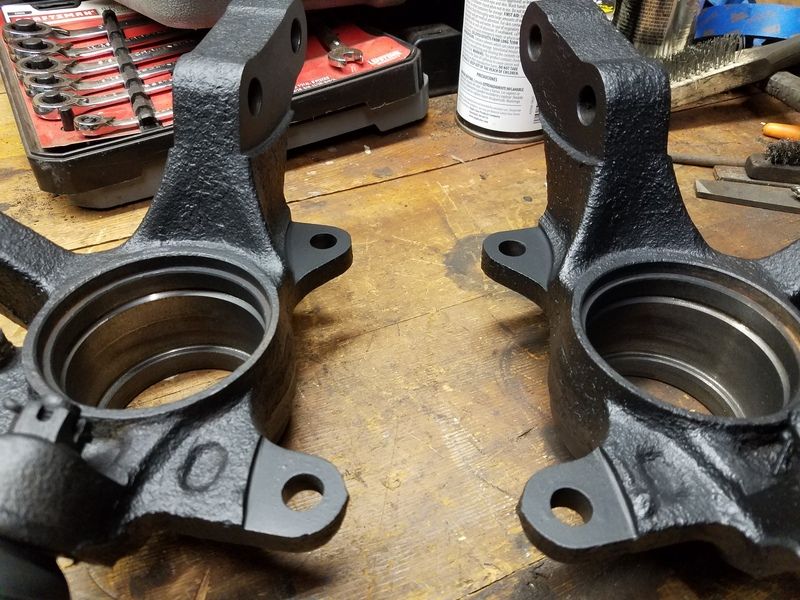

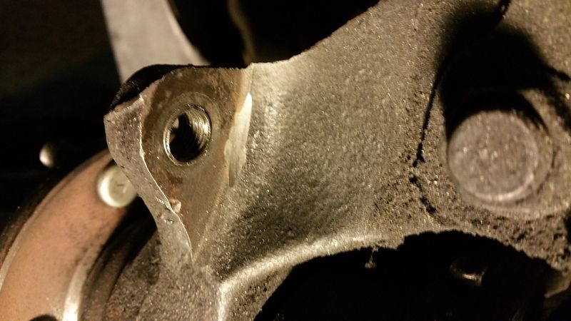

The 205 have the threads for the bolt to hold the caliper on to the knuckle on the knuckles vs the 165 having the threads on the caliper. I have seen other builds which thread the knuckle with a larger bolt but this requires you to also drill out/make the holes in the caliper larger too. I have also seen people use a bolt and nut which puts the nut in a very difficult are to hold back up while tightening. Ive also seen a bracket with threaded holes in place of the nuts, but still difficult to position and hold while lining the caliper and bolts up. These options did not seem optimal to me.
I ended up using a product called Time-Sert which threads a threaded sleeve in to the knuckle. This allowed me to use the same thread and size bolt which was originally used. Usually you have to drill out the hole but I found that the hole in the knuckle was already the right size and only needed to be cleaned up before being threaded for the sleeve. A M12 x 1.25 x 11mm Time-Sert was used and the kit was only 100 bucks which I split with a friend who is doing the modification to a 6gc.
10mm length sleeves would have worked but the 11mm gave me some over hang so I could use the supplied countersink on the caliper ears, giving me a small shoulder. This makes lining up the caliper to the knuckle a little bit easier.
Some of the knuckle casting had to be dremeled down to clear the caliper ears. I actually replaced the knuckles when I did wheel bearings later and cleaned up a new set of knuckles. I swapped knuckles primarily to get rid of the factory camber thing and to put new bearings in.
The shoulder from the 11mm sleeves

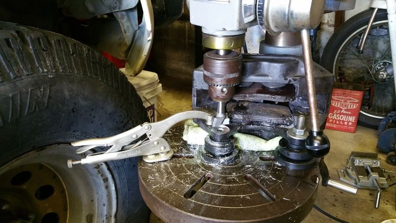

Shaving down the Caliper ears:
Shaving the 3mm off was done with a drill press and a Magnate 2704 Surface Planing Router bit 1.25” diameter. I used spacers from bearing puller kit to allow the caliper to sit flat on the drill press table and clamps and bolts to hold it down to the table as I took material off with the drill press and router bit. I made sure to measure before, during, and after with a caliper to ensure only 3mm was removed
