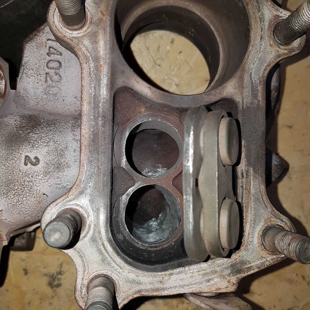

Massive boostcreep was due to an sticky wastegate. Perhaps damage with shipping, dunno.
Anyway, solving the sticky wastegate did solve the massive boostcreep, but not the "normal" boostcreep. Next week the turbo is going to be removed and the wastegate ported. It must going te be something like this, found on the world wide web with some MR2 folks:
https://www.dropbox.com/sh/n595gbzv2bhb ... WyLNIAhcqa
On the other hand, I am surprised that ATS is selling an 'super' high flowing turbo, install an 0.6 bar wastegate but do not port the wastegate??? To me, it think that should be part of the deal/package. :shrug:

Postby Gert » Sat Mar 09, 2019 12:08 pm
Somebody must do it: :D
Now I did see the difference between de stock turbine housing and the CT27 one.
If time enough, I will post some pics later.

Hmm, forgot to mention: the turbo was having an sticky wastegate. First post above I see boost creep was up to about 1.1 bar at 7.500 rpm, but later on, with mapping it was much worse.
She saw 1.4 bar at 5.500 and rising! So we quit mapping and tried to solve boost problems first.
So, we fixed the sticky wastegate, but that was not enough, still seeing 1.1 bar under wot.
Now, because of the bad Celica intercooler design, I installed an ERL waterinjection system, with an fail safe option. ERL is injecting from 0.7 bar, because the stock wastegate is 0.6 bar. Normally, no waterinjection required with 0.6 bar or less.
So, if I (or somebody else, wife, kids, everybody uses the GT4) are pushing with 1.0 bar and the ERL is going into error, boost is dropping to stock wastegate level. Untill now that always worked fine. But with this kind of boostcreep, the whole fail safe option is useless.
Ported the wastegate now, and hope that we can map the car soon, starting with normal boost levels.

Postby Gert » Fri May 31, 2019 5:34 am
Busy lately, not much news.
Ported the wastegate. Ported too much. Burnt a whole in the turbinehousing while boosting and let it weld by an professional welder. Hope it holds.
Anyway, the porting went so good, boost is not getting higher than 0.7 bar now. Even if I disconnect the waste gate actuator: still 0.7 bar...sigh.
Probably the wastegate is not strong enough to keep the door closed. So, more testing to do, but no time left. Not really a problem since furtheron, the car goes strong and runs really well.
