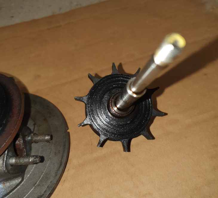

First the ERL water injection is having a leak. Found the leak, contacted ERL and now waiting for response.
Very old part, probably not available anymore.

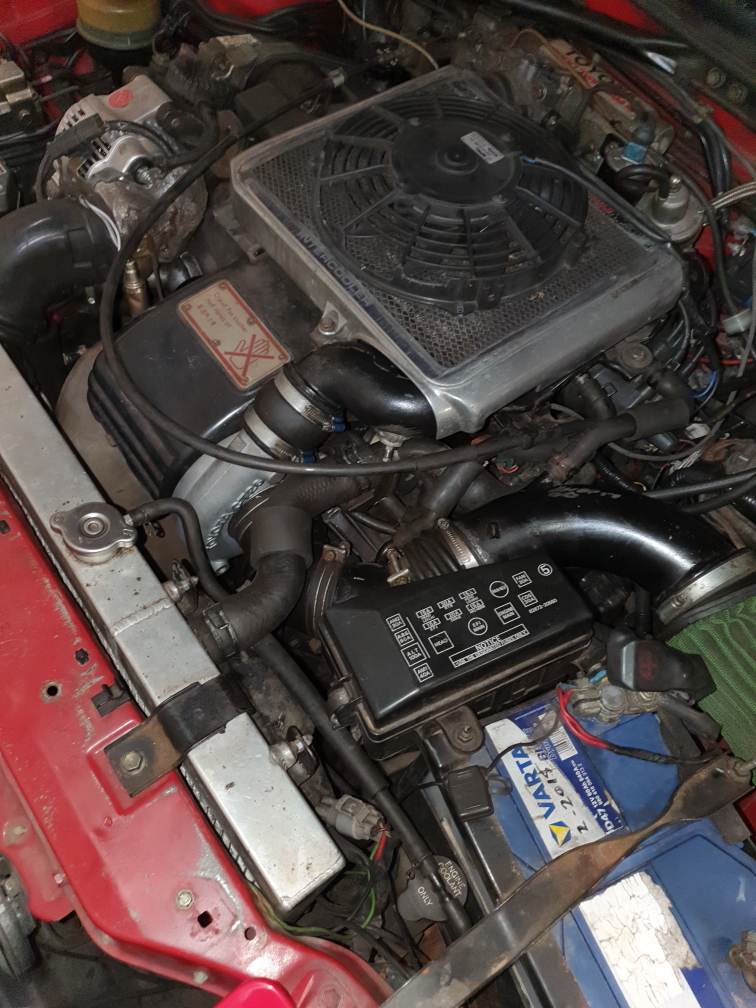

Than the intercooler adapter. Well, the gt4play one is having an 60 mm (actually it is 63 mm) intake and the intercooler is having an 50 mm outlet. *Sigh*
So I have to fix and fit the gt4play adapter or I have to fix the stock intercooler outlet or I can try to get me an new build intercooler.
Ordered an silicon reducer, everywhere available, but when I took an close look, the intercooler outlet is not exactly lined up with the throttle body intake (??). In the 27 years I own this car, I never noticed this!
