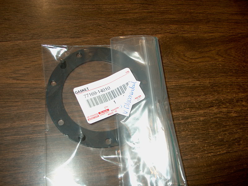

Postby Gert » Thu Apr 21, 2022 6:19 am
Finally, I got mail from ERL: if the system is going down, no parts available anymore, buy new... *sigh*.
Ofcourse an new problem occured. The filler pipe is rusted. Wholes in the pipe and the plate is very bad. Another challenge.
Only the gasket is deliverable. :)
Gert
Posts: 145
Joined: Tue Sep 29, 2015 8:53 am
Re: T-vis gone bad, engine damaged

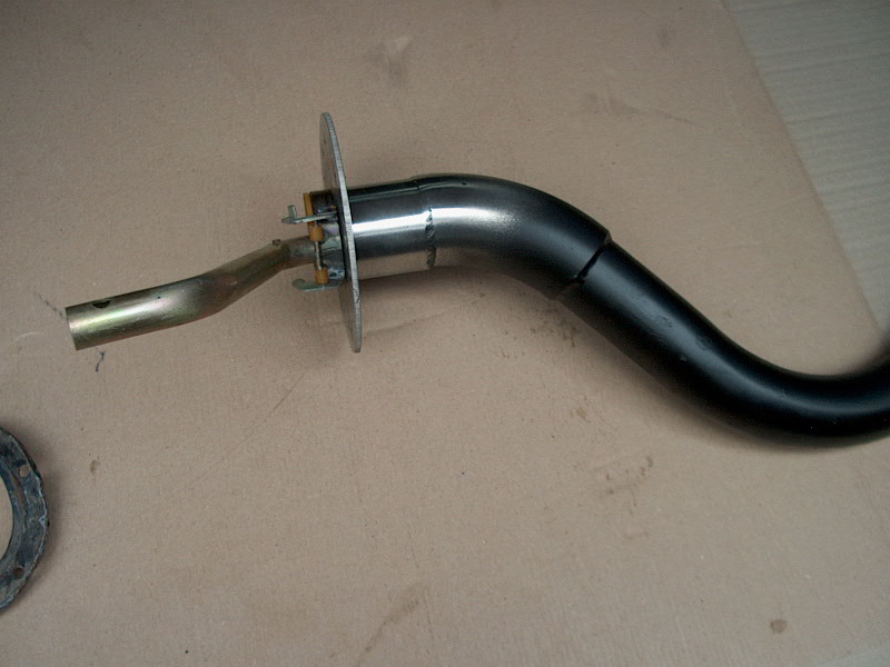

Postby Gert » Tue May 03, 2022 6:18 am
Gasket on my desk now:
Filler pipe is at the welding shop. They try to fix it.
Gert
Posts: 145

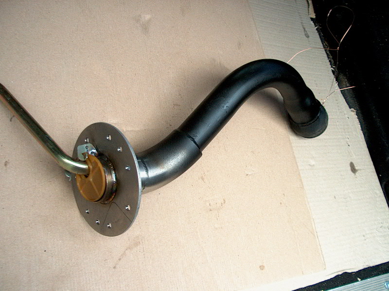

Postby Gert » Mon May 16, 2022 1:42 pm
Guess what, fuel filler pipe is back. Dunno the costs and dunno if/how it fits, but the first impression is good:
Bend is stainless steel now.
Gert
