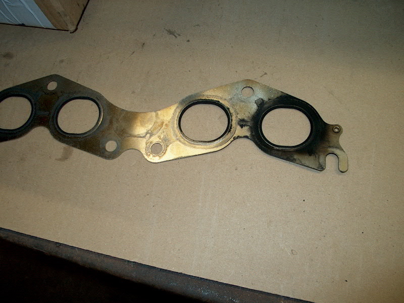

Postby Gert » Sat Oct 03, 2020 2:30 pm
Sigh, cracked manifold and warped too:

Postby Gert » Mon Mar 15, 2021 9:35 pm
Six months from installation and about 2.000 kms. She is going strong and runs excellent. Me happy .
