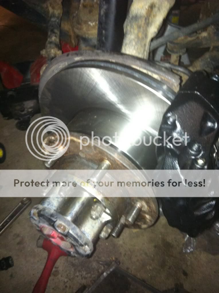

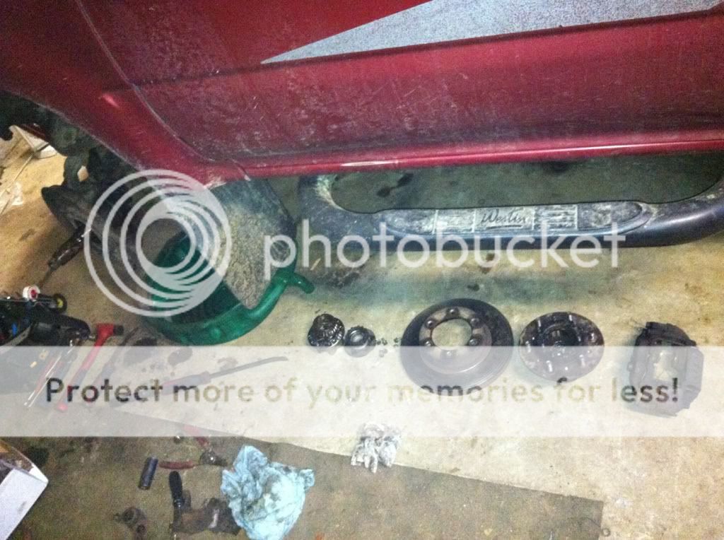

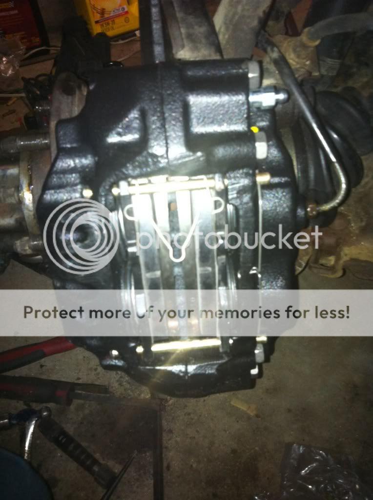

Also when my loan is paid for this car I get the money back, then I'll have the money for a nice turbo, and then some. My short term goal is to get this running at stage 1 and built to withstand big power. this way i dont have to pull the engine again. Once this car is running reliably I'm selling my Truck, which I'm doing a brake job on calipers, rotors(bolt on maunaly locking hubs) and pads... $400 parts, PITA. Looking forward to having a sick gt4, that the brakes are much Easyer to replace.

Image new brakes
Breakdown ImagecalipercloseupImage

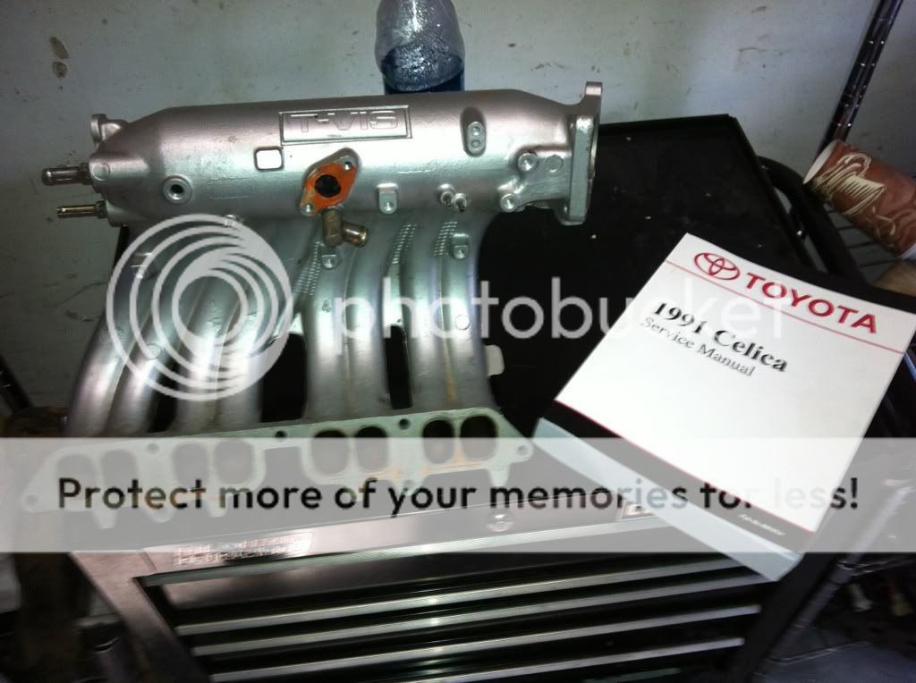

Picked up this GReddy Emannage Ultimate, working on a patch plug, I believe it came with an AFM sensor with plug, not sure yet though.
Also picked these up today, for thoes who can't see the right side of the photo there is also my new 1991 celica engine manual ( celica bible ) :)
