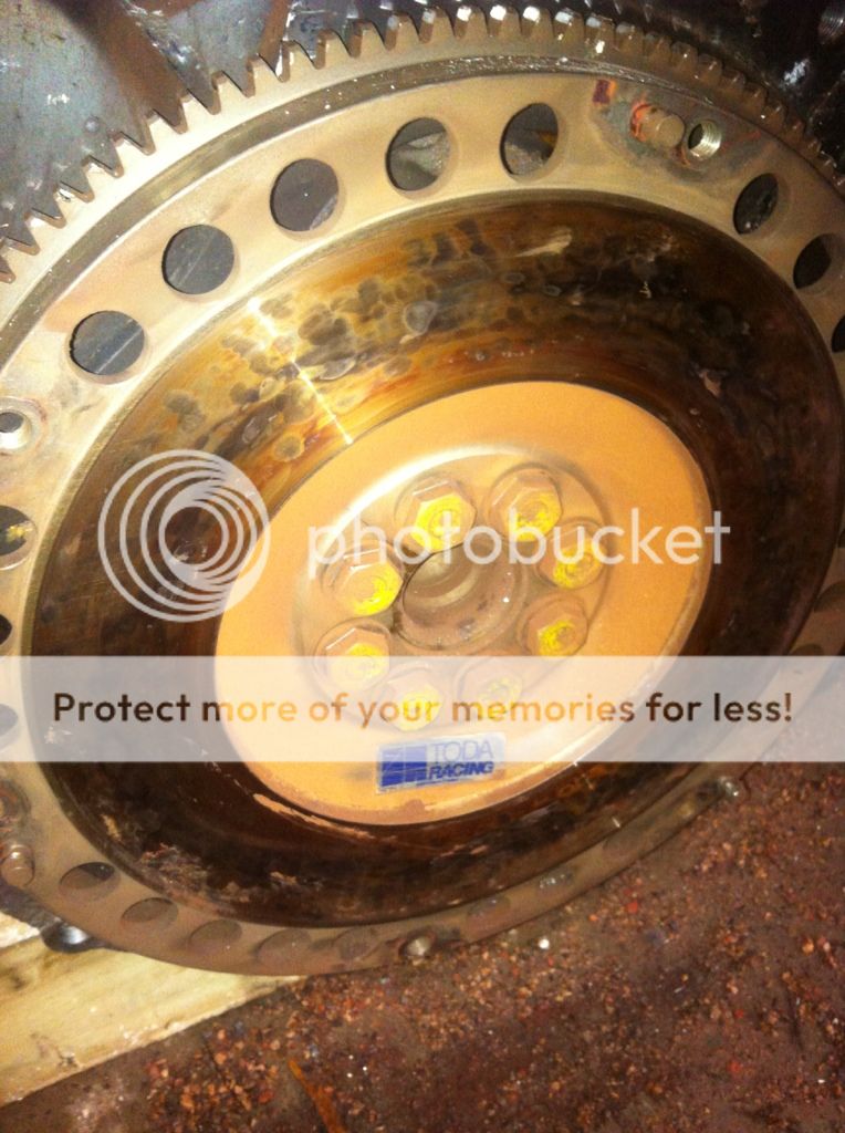

I finally got the trans off the engine, only to find a TRD pressure plate, Disk and a Chromoley 4.5kg (9.92lb) flywheel!!
Getting that Resurfaced this week, then my ACT 6 Puck un-sprung disk, and heavy duty pressure plate will go in, trans back on.

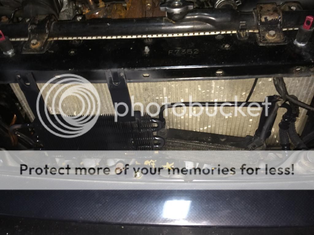

Installed the engine back into the st185, still waiting on my wiring harness
. Found a huge trans cooler from a Benz, plan on using that, need to get hoses and adapters. Ditched the Greddy Emanmage, gonna get her started on stock electronics and ease my way into a Megasquirt.... Picked up some Hel brake and clutch flex hoses. They look nice and are cheaper than OEM replacements, plus they have a lifetime warranty
. Degreased my front cross members and re painted them.
Removed everything from the grill area to make way for water to air heat exchanger, larger trans cooler (just going to bend some 3/8in soft copper for a larger subcooler.) plan on installing two push fans bracketed to the alloy crash bar.
Still need a dizzy rebuild, a water pump for the IC. Misplaced my shift cable clips for the trans. After some brass shift bushings aswell. Once it's started I'm off to the fabrication shop to fix my rear subframe mounts and other tender spots. Roll cage, seem welding, game bar, rear tire carrier, braces, skid plates are on the bucket list but down the road a bit.

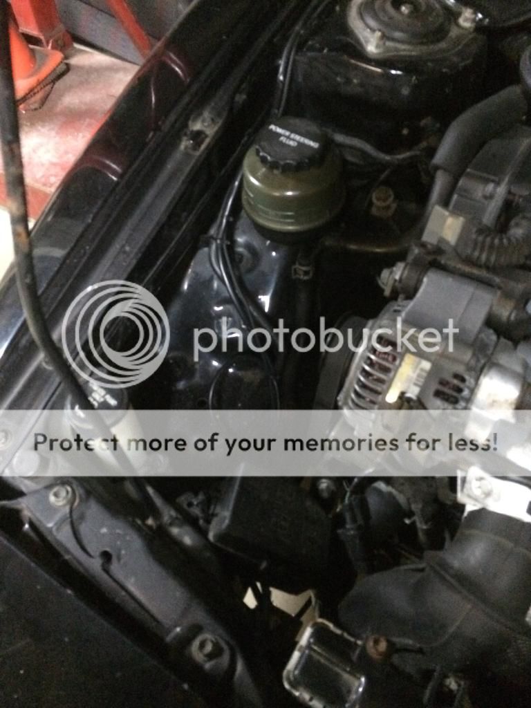

Harness nearly finished, intake back on, worked on installing the motor mounts... Sent them to a shop to be pressed.
Picked up an oil pressure gauge (greddy)
Need to get some gear, engine oil. Still working on finding adapters for my Benz oil cooler.
Gonna order a 600hp heat exchanger for the WTA, put in some nice alloy big CFM push fans.
Noticed my sway bar mounts are rotted... Much welding to come

Harness completed, car runs, still have to do error 54 fix.
Still working on the race mounts from Klue.
New Stainless brake hoses are In new wheel bearings and seals installed
New axles in, ABS delete completed up front (sensors and brackets removed from
Hub)
Still have to tidy up the harness, and battery relocation
Needs an air box, catch can, over flow tank for Rad and intercooler.

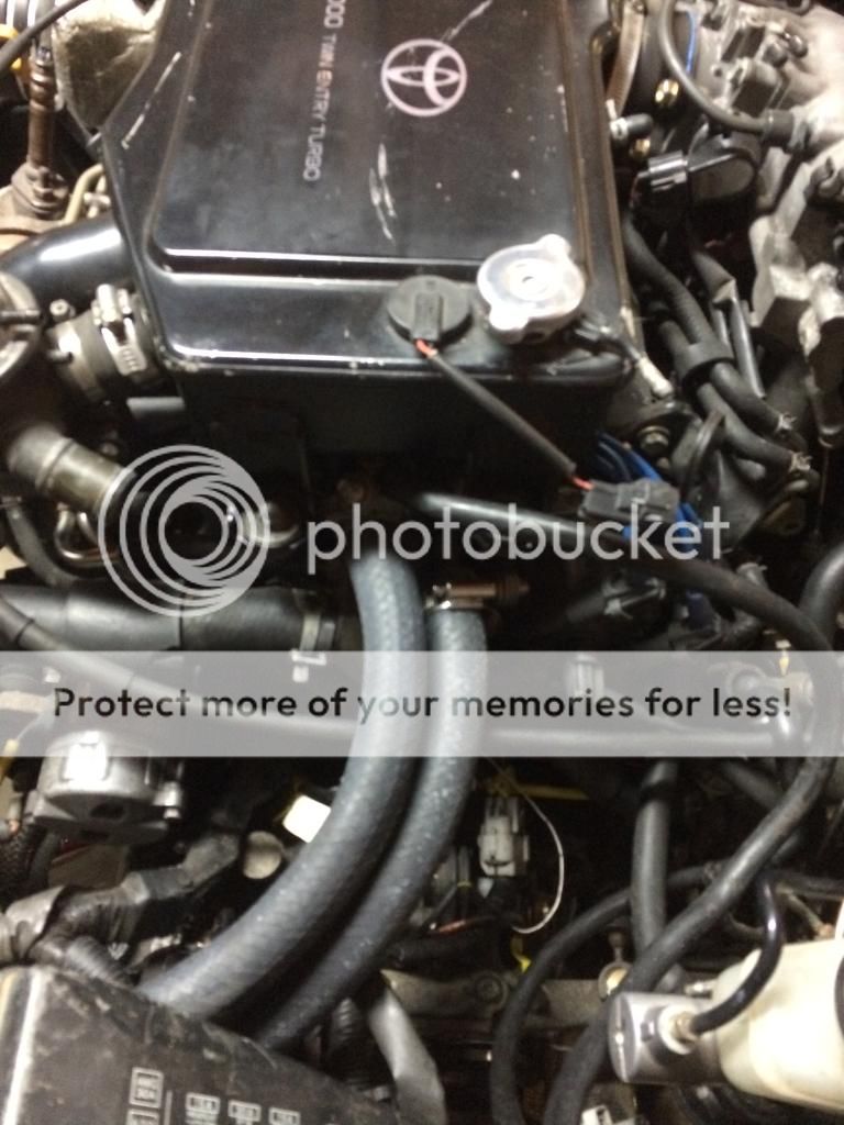

air to air FMIC converted to 3/4 NPT
29gpm 9psi stall flooded suction pump. Marine rated, brass impeller
Intake hole widened, inner fenders to come b4 winter
1inch hot water hose with high tension pipe clamps
Starting to fit hood, fenders, wheels, heat exchanger

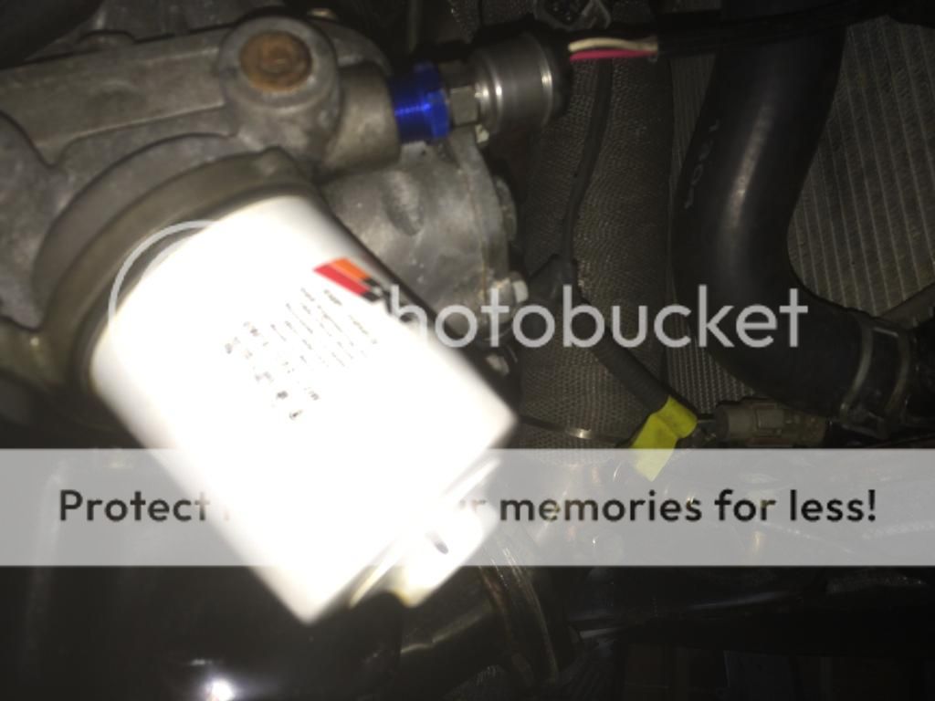

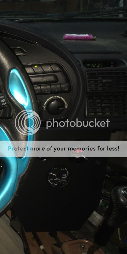

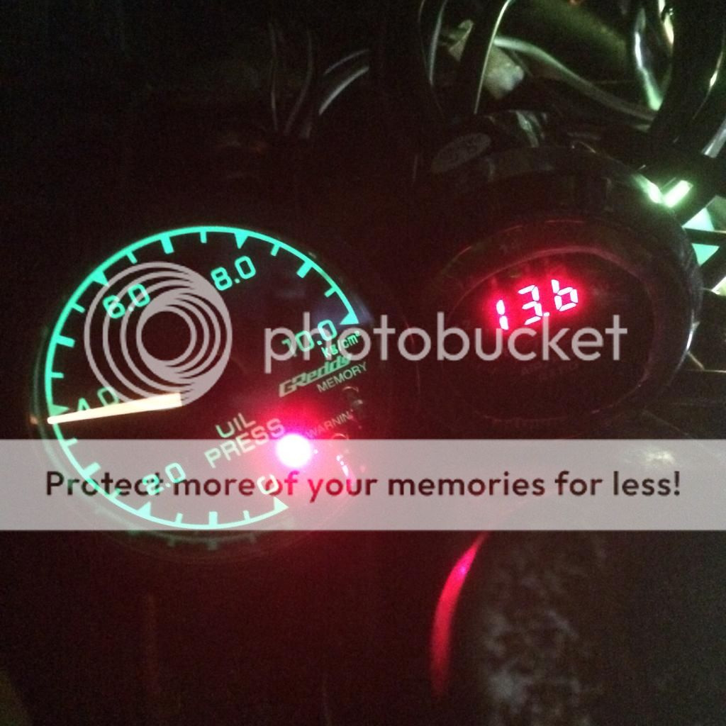

Oil pressure, AFR sensors/ gauges installed (cold idle)

Quick release steering wheel, fabricated a new center panel for gauges and switches.

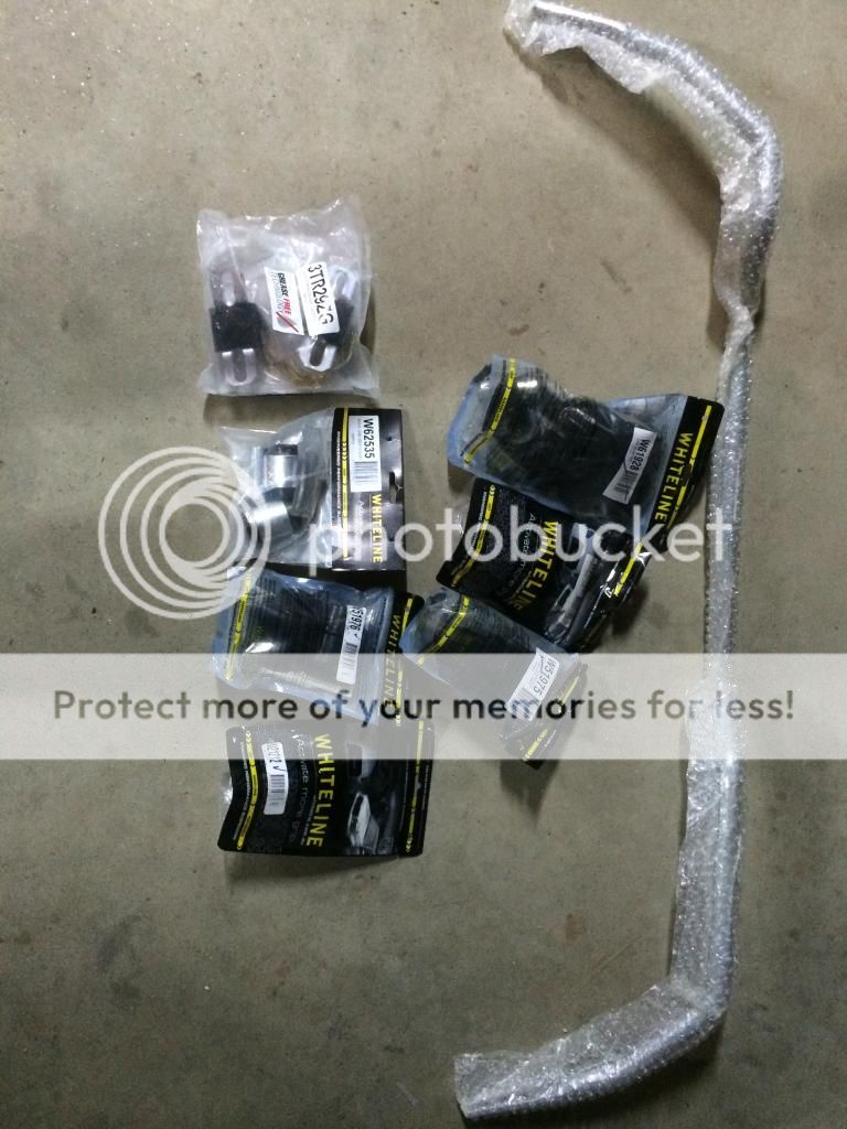

Adjustable rear sway bar and bushings, should pair Nicely with the race spec dif mounts

A side note that with the uprated W2A system
The top mount stays cool to the touch, even after an hour of spirited driving.
I also upgraded the power steering cooler, and finally stopped the leaks (for now)
