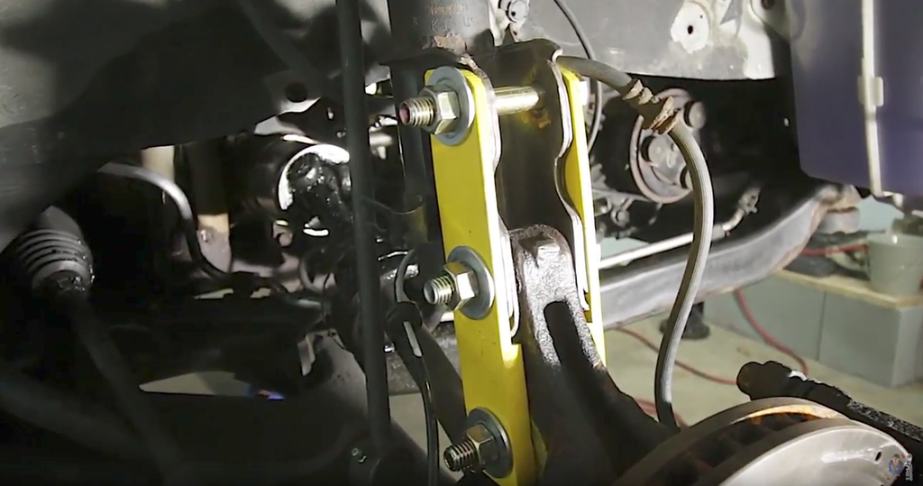

So I just stumbled across a new idea, lower strut spacers. These guys make them for Subarus: https://www.weareflatamp.com/product/2- ... egory_id=3
Another guy made some for his van on Instructables.
Has another heard of this before? It doesn't seem very common but it gives you more tire clearance which is nice, and it would be a lot easier to pop this on and off which I really want to do. I'd like to be able to run the lift for winter and take it out for the summer but fully removing the rear struts to take the spacer off the top is such a hassle I haven't done it yet.

That's gonna make for an angry CV joint.

The CVs might be fine but I realized the limitation of that kind of lift, because the lift height is set by the bolt spacing it would be a 2.75" lift in the rear, which is way more than I want.
