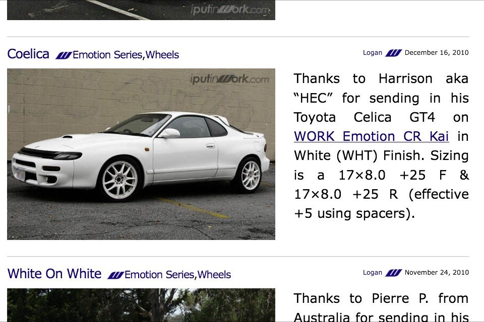

Postby gt4lm » Sat Apr 26, 2014 5:38 am
gt4lm wrote:well i bit the bullet and made the order for custom offsets for the widebody
lets hope i got it right otherwise im in the hole ( @ @ )
i went for
front 16x8 + 25 Front
Rear 16x8 + 5 Rear
my mission was to escape spacers
i will start a thread of my own when i have something to actually share with you all :)
So just when I think I worked out a great size someone had a already done it hahahah
I'll have to be a pioneer in something else - at least I get a visual
