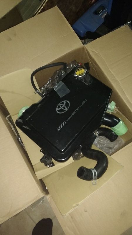

Finally getting back into this, want it up and running by the end of the Year. Got a nice present from our Celica brothers in norcal for cheap...

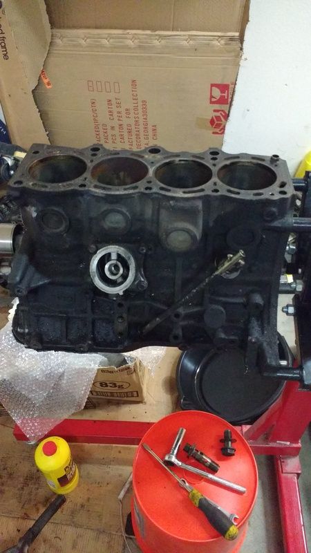

Got the Oil pump assembly off....
Crank out!
Time to get this guy to the machine shop this week :D

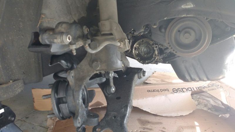

Postby awdmofo » Tue Feb 07, 2017 5:37 am
So the block I have has been honed out once before and the shop wants me to bring them the block in my car now. I think its the original block with no rebuild so i removed the axles and suspension, pushed the brakes to the side, removed the subframe and lowered the engine/trans out from underneath.

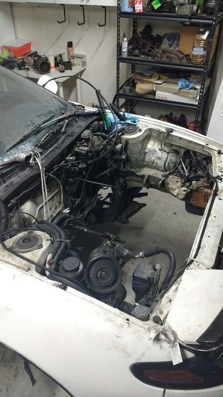

Postby awdmofo » Mon Jul 17, 2017 10:52 pm
Finally got her home, now to clean out the engine bay remove the steering rack to be rebuilt and get some new engine mounts!!! :D :D

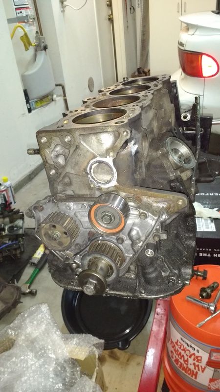

Postby awdmofo » Fri Dec 15, 2017 3:28 pm
Its been a rough year, basically the hardest year of my life. Working full time, college part time at night online, my dad passed away at the age of 65 in January and I moved home for most of the year to take of my mom. All that said, my dad was into cars at a young age, rebuilding engines and buying/selling cars often like me when I was a little younger. The beast has sat too long, its time to get this engine put back together, install a lightweight flywheel and strong clutch, replace the engine mounts, lines, hoses radiator and install an external oil cooler. This baby must be driving soon!!
I will reload all the pictures from my past post this xmas break, stupid photobucket :shoots: :nono:
Got her up on the stand, ready for some degreasing and pipe cleaning for those coolant passages...
